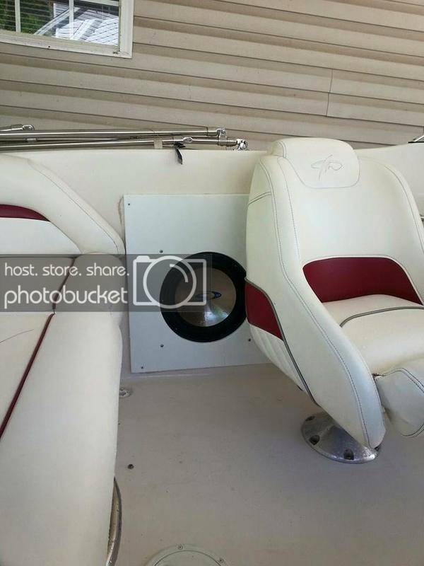

The sub will be under the driver seat outside, i have 2.5 cubes net and box will be ported (round ported)and this is not and easy task to build at this place but i don't have a choice!
Just be sure to have sub and port fire opposite a wall or seat ect... To "load" the sub to some degree. It will have better sound and get much louder that way, if you can do it...
The last one I did, port firing off of the seat down low ....custom 2.6^ft enclosure built into the hull ....
Thanks for your help and good job with your box:)
I built my box at 2.4 cubes and the sub firing the back of the boat and port opposite and firing under the dash (wall) i put 4 inch port by 8.5 inch long.
