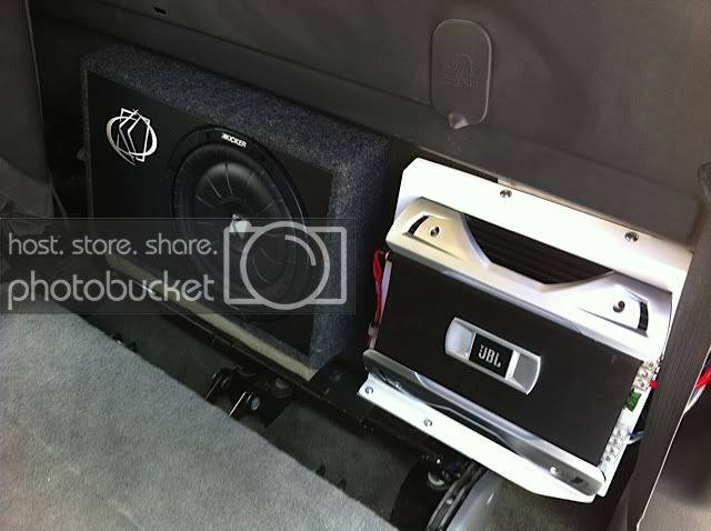

If you want to add a little punch get a space saving sub and an amp which will give you the thump that small speakers can't.
Here's the smallest 10" sub unit that I could find and with moderate power (360WRMS), and a moderate cost which pumps out some pretty decent lows. Not earth shattering but clean. You wouldn't want too much anyway without upgrading everything else too. It all fits in the very limited space behind the seat in my crewcab.
