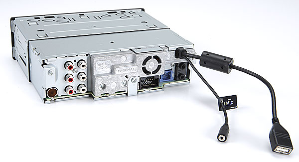

My old alpine had the traditional white and red output plugs for rcas to my amps but now i have these other RCAs labeled front L, front R, rear L, rear R, and subwoofer output. How am i supposed to plug my amps into these? does my component amp for the fronts plug into the 'front L, and front R'? Where does my subwoofer amp's RCAs go when the 'subwoofer output' for the h.u. only has one plug?
this is what im used to fyi
well what i mean ( i know i dont have the right terminology here) is that there was one SET of outputs ; the headunit had 2 outputs, but each ouput had two plugs (white and red). this headunit doesnt
the old alpine i had was exactly like the one i pictured
you still have a set of outputs, you have 2 sets FRONT and REAR
One set for the REAR 8 and 14
one set for the FRONT 9 and 10
as for the subwoofer output 13 you use a RCA Y-Adapters
