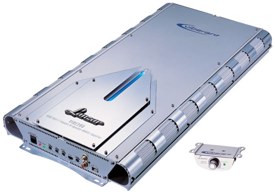

Well I have a 2 Channel 4000 Watts High Power MOSFET VIBE286 amp. Like so..

The Amp does 4000w MAX and
2x 300w at 4 ohms
2x 450w at 2 ohms
2x 2000w at MAX 4 ohms
1x 4000w at 4 ohms BRIDGED

bridge the amp - do this
Start with the gain at MIN. You can always increase it if you believe you need to.
That amp is capable of around 900w and using too much gain COULD cause problems for those subs.

you will be fine, that amp wont put out close to 4000 watts, so you will pretty much be fine wherever you set it

It's a 900w rms amp -- the 2 x 450 at 2 ohms equates to 900x1 bridged.
A 900w amp with the gains set too high could produce enough excess power (clipping) to be a problem for those subs.

okay so if you take your fuses (two 35 amp fuses) and add them together (70) and then multiply that by how many volts you will give you amp (we will say 14) you get (980) watts out of that amp. provided you give it full power, you are not gonna get even close to what you think it does, not to be a dick, but you get what you pay for and im tryin to help you understand
