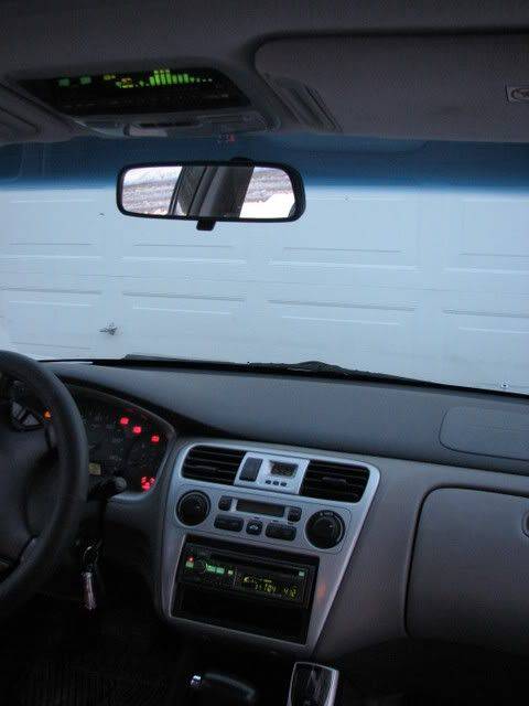

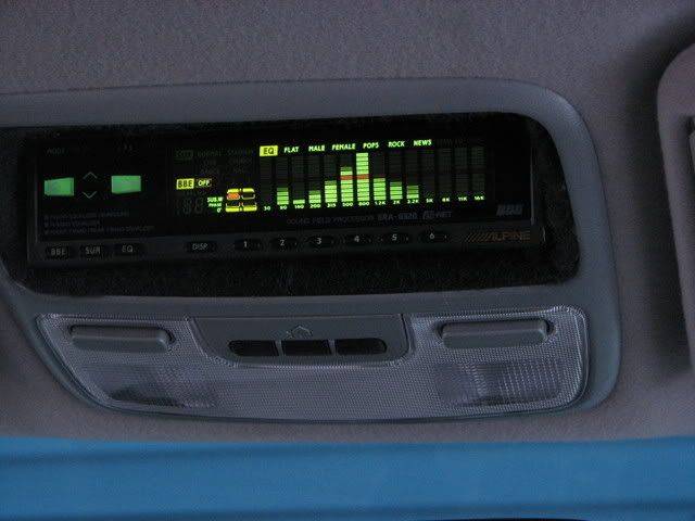

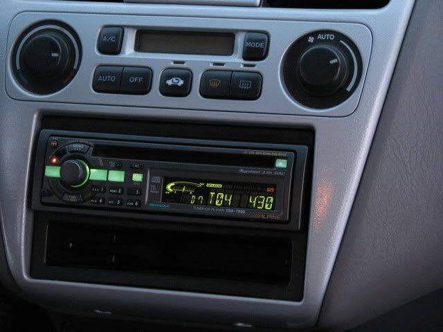

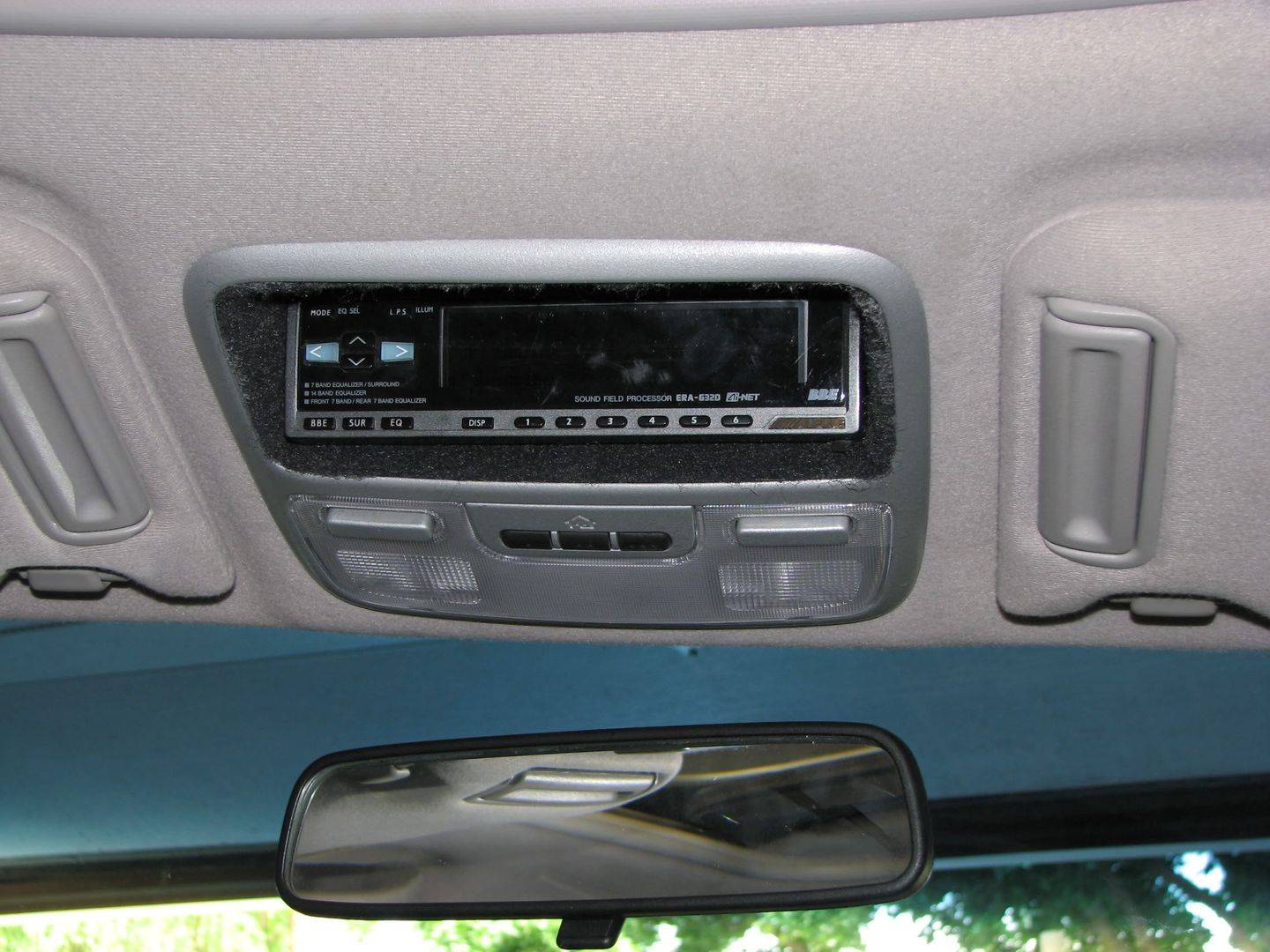

it is compatible with any headunit with RCA output but best suited for use with an Ai-Net Alpine head unit (CDA, DVA, IVA series). Ai-Net cable offers both audio and control in a single cable. You need the remote display controller to make adjustments. It is the same size as a single DIN head unit. I located mine in place of the overhead sunglass holder.

make sure you get the 17' controller cable with it. do you have an Alpine Ai-Net head unit to pair with it? it's my strongest recommendation you do.
