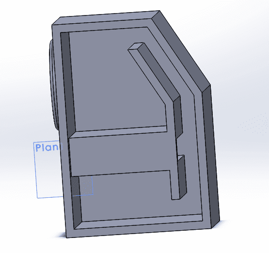

Some news, I take good mesurment of the space I have :
18961
I made some simulation for the port on subbox pro
18962
Because of the space I have and the length of the port, I decide to do a « T » port, I will put it on a side, this let me 5 inch of free space between the other side
18963
What do you think?
