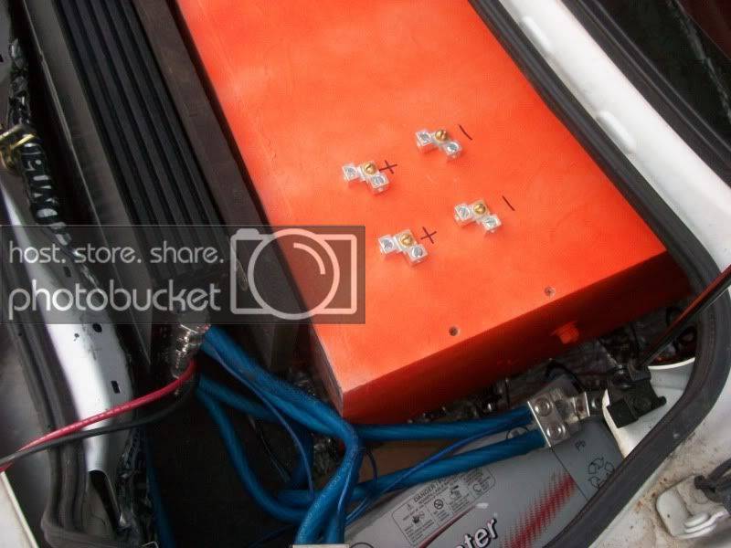

this is best option for switching ohm loads. terminals on both sides of the box (inside and out)so u can alwasy switch up any wire and stuff.
12cubes net would be nice, 16^2 port area per cube. 35hz tuning will be strong on the lows. Do 1/4-20 bolts for terminals on the back of the box. Do a set for each sub so no wires show through the port. you can jumper them on the outside of the box until you get the 2nd amp.
