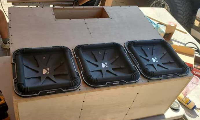

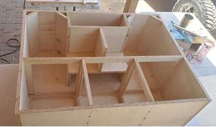

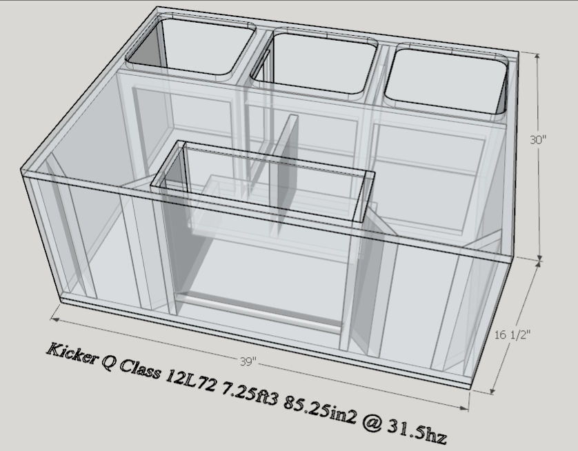

Best box?.. that's pretty vague. This went into a Dodge Magnum and pounds.
I suppose it could have been bigger but the vehicle had space constraints and its getting a Korean 4K wired .67 once his electrical is solid so it's sized about right imo.
