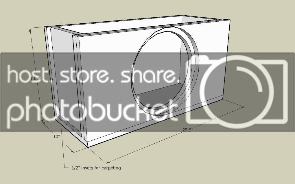

I just took some measurements of my trunk and I have these to work with: 14 high, 16 deep, and up to 30 wide. The sub will be powered with a Diamond D5 1200.1 and is going in the trunk of a Chrysler 300C. I'd like it to be very musical (good sq), have great low end, and be able to blend in with my Boston Acoustics interior speakers. Sealed or ported doesn't matter but if ported I'd like it tuned low. Any help?
I started working on a ported design but the space is a bit too small for an optimal ported enclosure...it would be right on the line of being too small and you would have to start sacrificing port area, etc etc...
But here's a sealed enclosure, it will come to 1.129375 cubes net, with .5" insets on the sides for easier carpeting..
Any Q's just let me know //content.invisioncic.com/y282845/emoticons/smile.gif.1ebc41e1811405b213edfc4622c41e27.gif
So I don't have enough space to work with for a ported box, huh? If I need to go sealed, I'd like to have 1.5 cubes net after displacement. It could be 1.25" taller and can go 5" or 6" deeper. Will that give me enough room to work?
Using 2-4" Aero's with box volume at 2 cubic feet tuned to 30Hz port length would we almost 35 inches each and will not fit in the box. Now if he uses 1-4" Aero then it will fit.
Do you even factor in port displacement?
Two 4" Aero ports 28" long will yield a box of...
2.42ft^3 tuned to 30hz.
And you can bend Aero ports if need be...
oh, if that's the case how small could I make the box? I'm cool with anything down the the FI recommended 1.8 cubes for the sub. I need room in the trunk for the stroller....lol
