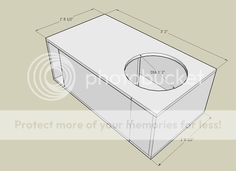

Guys I need a favor. I am looking to build a new box for my BTL that fits under the stock cargo cover in my denali. I know some of you get bored and don't mind helping. If any of you have the time to design me a box and provide a cut sheet to help me out that would be greatly appreciated.
What I need is around 4 cubes after sub displacement (.21 according to FI) tuned to about 36-38 hz for my daily driving denali.
Height needs to be 14 inches to be fit under my stock cargo cover
Width needs to be 38 inches so I can get to my stock Jack incase of a flat.
Sub up and the port along the bottom of the front.
Thanks in advance.

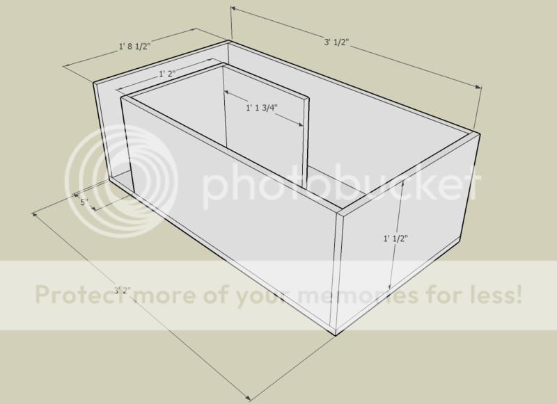

Here you go:
Right at 4 cubes at 36 htz
Ill get you a cutsheet if you like it.
