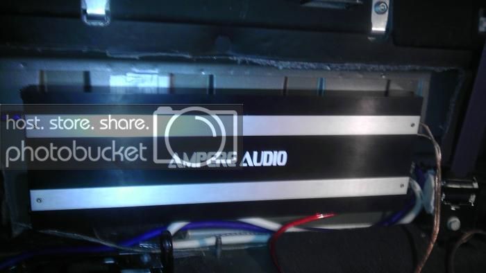

I am running 4 sa8v2's on a ampere audio 3500.1 prototype. The amp will be available to the public in a couple months max.

Anything 2k or so would be fine. Find a good deal on a used 2k amp then buy a 3500 when you have the money saved. I will be able to get you a Ampere Audio when they are available if you like. Great Zenon based amp
