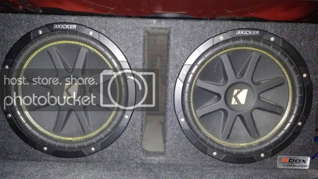

*NEED ADVICE* or opinions on my setup i recently purchased.
I recently purchased this setup off of Craigslist for a great price. I was thinking that maybe, the amp may not be enough for them so i wanted to post on here and see what you guys think. I have two 12" Kicker subs and powering them is a SSL Edge 800w Amp. Should i keep this amp or should i upgrade it right away? It seems to play them well so far without getting hot but i feel like if i got something bigger maybe i could get more out of them.
The amp does 800 watts bridged to one channel at 4ohms.
Both your subs together do 500w rms and peak at 1000w rms. Really id say if you try to power both those subs at full peak wattage you prob would blow it.
From the fuse rating of 1x40 your amp prob does max 500 watts if anything or less so its your choice if you choose to upgrade.
At full gain on the amp youll be running the subs at its normal rms rating.
do you even know what your talking about.... Full gain does not = normal rms rating. Full gain = blown subs/amps. Gains should be set matching the input voltage of your head unit. You also never Use Peak output/power for ANYTHING its just overinflated garbage numbers they feed the unknowing consumer to sell their junk.
Op, you bought a very basic bottom of the line beginner setup. Not sure how loud you want it but It'll do for some bass fill. That SSL amp is for speakers and tweeters and its in the junk category of amps so you'll be lucky seeing 50 rms a channel out of it. The subs are not that great either.
What bmk6795 meant about the box is that its a pre built cookie cutter box. These are generally poor designed boxes that does not have enough port area and is tuned pretty high so it wont dig into lower notes and generally sound not as pleasing.
If you have high expectations of loud bass, you might as well sell it all and start over with proper equipment. If you dont care and just want some bass fill then you can keep that setup and run it.
that setup is not worth anymore then 120 to be honest.

so you want us to butter you up and tell you lies? I'm just telling things straight up, There are waaay better stuff out there for the money. There are garbage companies that overrate their stuff and SSL is one of them along with boss, pyle, power accoustik and lanzar. I already said if your just looking for bass fill then that setup will work for you. Seems like your the close minded d-bag that refuses to listen to any advice.

Gain over the amp he is using would be nearly inaudible I'm guessing. Probably the equivalent of 1 click on the volume knob assuming no compression losses. This is a bit misleading since to SOUND twice as loud, assuming OP's amp will make 400W, he would need around 3500W, and I'm sure even a noob can guess how far those kickers would go on that.
IMO the first comment was correct in that the only real "upgrade" from where you're sitting would be a good box. Adding power would likely break those subs before you had a noticeable gain for your money and replacing subs on that amp in that box would be pissing into the wind.
The Kicker Comp 12 4-ohm SVC subs are rated to handle up to 150 watts each (so are the 2-ohm SVC Comp 12s)
Reference Links: Kicker 10C124 Comp 12" 4-ohm subwoofer at Crutchfield.com
2-ohm version: http://www.crutchfield.com/S-lDt1jZLfhtp/p_206C122/Kicker-10C122.html#details-tab
The Soundstream SSL Edge DG2800 is rated as follows:
200W x 2 RMS @ 2Ω
150W x 2 RMS @ 4Ω
Fuse rating: 1 x 40 amps
Reference link: Soundstorm DG2800 Edge Series 2-Channel 800W Mosfet Power Amplifier with Remote Sub Level Control
With a 40 amp fuse, the amp will be limited to max of 120 watts RMS per channel at a nominal 12 volts power, but may be able to put out more if your system can power it at closer to 14v. I have no direct experience with the amp, but per the specs, it is roughly well matched to the subs.
If you have the 4-ohm SVC Comps, then the best way to wire them with this amp is one sub per channel. If you have 2-ohm SVC Comp 12's then I would wire them in series to 4-ohms and bridge the amp channels into a single output.
I agree with the other posters that first thing to do would be to make an enclosure that is well matched to the Kicker Subs.
You can find info on box types and sizes for these drivers here: http://a248.e.akamai.net/pix.crutchfield.com/Manuals/206/206C82.PDF
Which Subs do you have? 2-ohm SVC or 4-ohm SVC?
