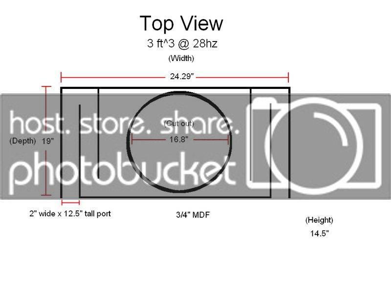

Need advice on Box for 18" TC-5200
Didn't see your reply, must've been typing at the same time as me. So if each one has to be that length, what do the measurements of each wall have to be acconting for the fact that I'm using 3/4" mdf to get 50.86 inches?
So how long do zig zagging port walls need to be each?
**** it, I think I'm just gonna use this tried and true box plan and run the sub on the top board facing up instead of on the same face as the port.
