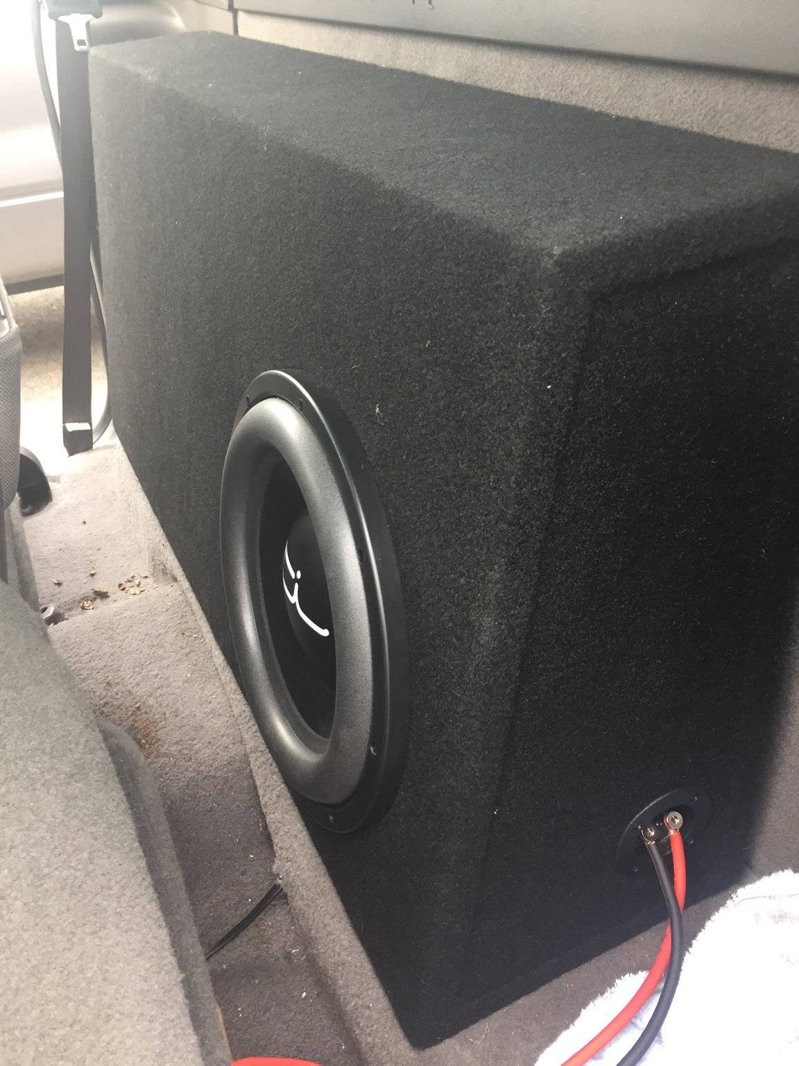

What is sticking out of the back wall? My box is flat on the back and fits just fine in my 2002 f150

The sticking out part I was talking about the armrest and the back wall of the truck is a bit contoured, not completely flat. The armrest was my major concern. I need the seat to be able to go back so I cant make the box stick out too much. I also need a place to put the amp(s). I would prefer to put them back in the box area if possible, but I don't want to have to do or buy a bunch of custom work. That's why I liked that pre-fab box. It fits and it has an amp rack area in the middle.
Even though I am old-school, I do much prefer a ported box. This is just such small space, I figured I would have to have a very custom box to fit the truck and get me the box volume I need. I am ok with 2 - 8" or 1 - 10", but I thought the 8's would be better because of the very shallow depth.

As for the box, well that's in the air for me. Building a box myself may be too much for me to bite off right now. I have built many, but I really don't have the time or a shop to do it in now. It would be a stretch. I am much more likely to buy a box if I can get what I need and keep the costs down.
