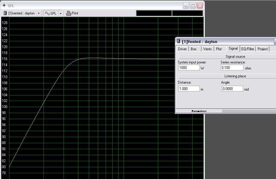

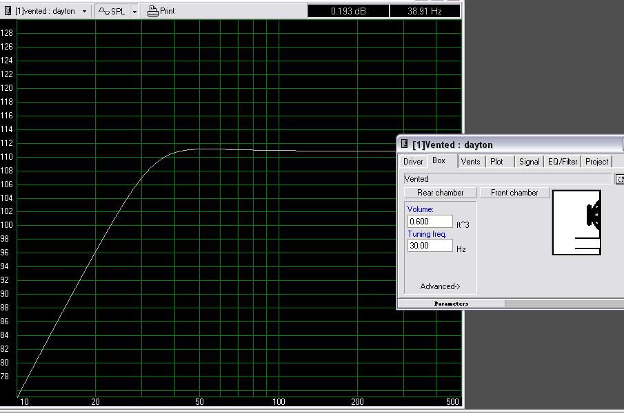

Here you go.
1 unit with 600 watts power
2 units with 600 watts power total
2 units with 1000 watts power total

So what do you guys think? Is it worth what looks to be a 3dB increase to move up to two HO10's? Will two really help me out with that low-end thump and output I want?

Yes, if you can keep from compromising enclosure volume, and your amp can handle the second sub being wired up, it's most definitely worth adding the second driver.
Not to say I told you so... but I did. //content.invisioncic.com/y282845/emoticons/wink.gif.608e3ea05f1a9f98611af0861652f8fb.gif
3dB is a noticable difference, for sure. That's what I would do.
