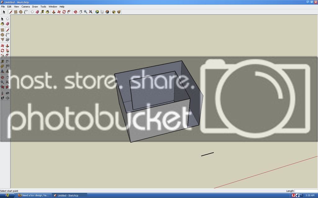

Well I downloaded google sketchup and tried to make a sketch, i had to adjust the dimensions because i wasn't sure exactly on if i could make a 3/4 inch think line but is this generally how it should look? and i wasnt sure on if you designed it to be sub up or sub back so i didn't add the hole in.
