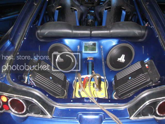

go to fiberglassforums.com and do a little research there. there is a lot of info on that forum. you can also click on my image in sig. io have a fiberglassing project that shows all i did when i did mine

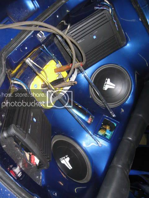

I always use a router and 1/4" rabbiting bit to go around the woofer rings, Makes a great notch to staple the fleece to the woofer ring. If the fleece is not hooked to the woofer ring tight, You will have a big problem with woofer support! Aka your woofer mounting ring will seperate from the glass and fall in the enclosure over time //content.invisioncic.com/y282845/emoticons/verymad.gif.3f39c5c2fd57527b671fad3efdfac756.gif
