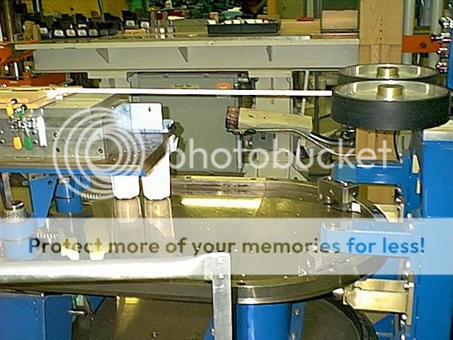

superconductor wire winding table, running cable around the center mandrel of the accelerator beam pole. The wire is white because its sheathed in fiberfrax, which is actually crystal fiber (similar in texture to fiberglass, but can withstand 10x more heat and pressure). This is to insure no coil winding short circuits will occur after high temp/pressure epoxy injection.

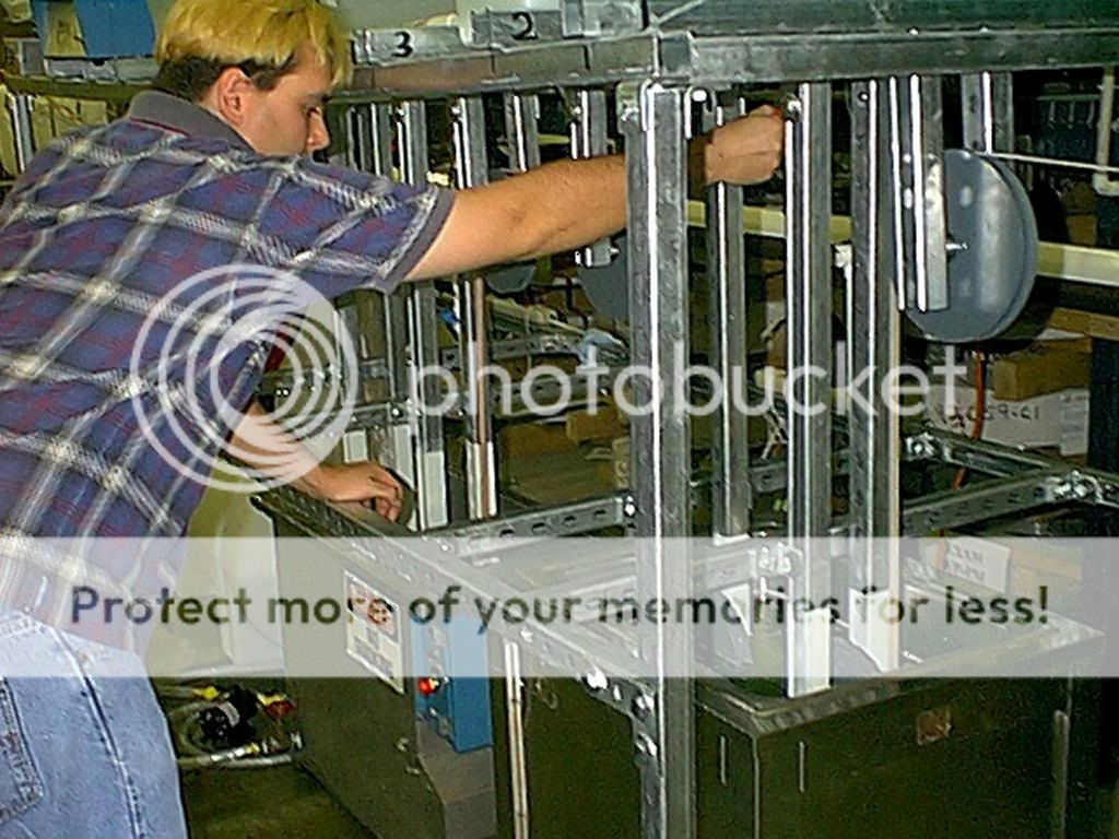

Thats me building my prototype ultrasonic deionized water cleaning system for the niobium/titanium wire. I had to come up with a way to clean the starch out of the fiberfrax before the wire is wound onto the coil and baked...otherwise starch at high temps turns to carbon, which is a conductor...and we all know that a conductor is a poor insulator //content.invisioncic.com/y282845/emoticons/laugh.gif.48439b2acf2cfca21620f01e7f77d1e4.gif
