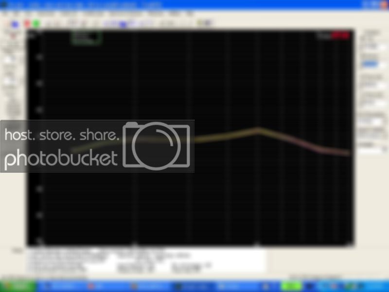

here is the in room response at the main listening position.
she's **** flat for a sealed box. +/- 4db from 12hz up to 100hz where i sit!

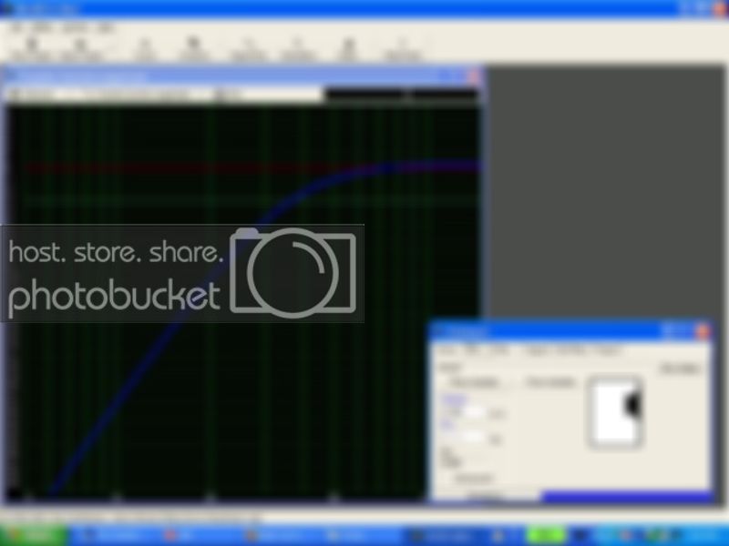

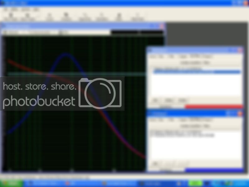

this is how the shiva-x models up in 3.32 net sealed.
i'm not sure how the current jbl driver models up in winisd because i don't have any specs on it. i'm hoping for very similar results, just with the ability to play the low notes without sounding like a mess.

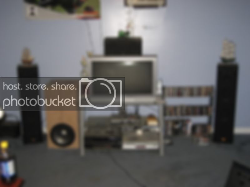

snapped a quick pic of the box as it sits right now.
not sure how or when i'll cover it. looks aren't as important to me as the sound.

to update this thread; i got the shiva-x, but it is defective. seems to be a mis-aligned coil. good news is that it's response it pretty sick. its only 2db down at 12hz. //content.invisioncic.com/y282845/emoticons/smile.gif.1ebc41e1811405b213edfc4622c41e27.gif pretty sick. DIYcable sent me out another replacement. i noticed the scratching coil when playing pink noise so it's pretty bad.

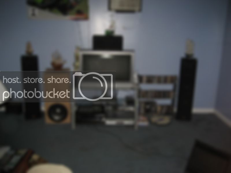

i had been neglecting this room for a while but here ya go.
all cleaned up! //content.invisioncic.com/y282845/emoticons/smile.gif.1ebc41e1811405b213edfc4622c41e27.gif
12?!
The human hear can't even hear 12 hz... =|
That's nuts.
Good for you. Many folks don't really know just how much effect the room has on response. Just watch the power you throw that thing now that you have it EQ'd..
even with the EQ'ing i should still be able to run her pretty **** hard. i guess xmech on it is 35mm. but from what i heard this sub is a bottomless design. it is suspension limited.
this is with the full 500 watts on it.
