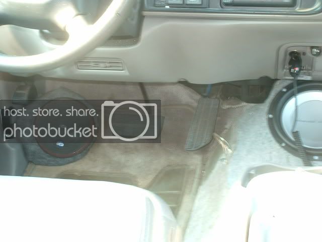

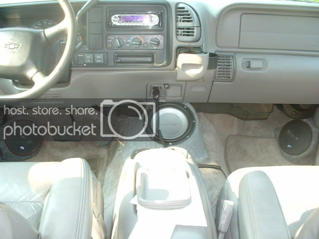

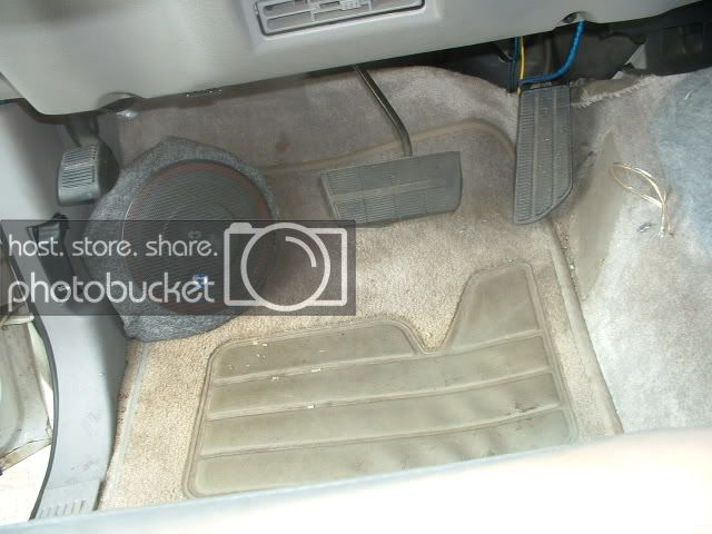

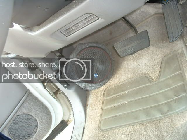

I think I might've F***ed up direction its pointing...I wont know how it sounds till tommorow, when I get my New Amp Right now im only running my right channel because my amp's left channel Blew.....anyways...yea, got up at 9 am sharp....got done at 5:38 //content.invisioncic.com/y282845/emoticons/crazy.gif.c13912c32de98515d3142759a824dae7.gif ....im whoooped...and I reak like hell
Questions Comments?
//content.invisioncic.com/y282845/emoticons/biggrin.gif.d71a5d36fcbab170f2364c9f2e3946cb.gif
they look crosseyed and dont looked to formed to the shape of the car.
The one I did today was kinda off...when I shaped it....on the very left there is a large dip in the plastic and it was kinda hard to fiber glass it exactly...
And I know they do look kinda cross eyed..but im gonna see how it sounds 1st before I scrap left one (the one I made today)...the right one sounds great
looks like the right one is pointing out the driver side window, and the left one is pointing between the 2 front seats, better than i could do though, good job if it sounds good though!!!!

Well for one, they're not an odd shape, they are circles, it looks like an odd shape because the circle cut outs are laying right next to the base, it doesnt protrude that much
#2. I tried to aim it towards the driver seat head rest....it was hard because I would've have had to have the speaker close to flat....all that was really off today was my aiming of the ring.
# three....my right side one sounds great....and is pointed right towards my head
personally sometimes off axis is ok but in this instance (unless by some miricle of god) it shouldnt stage evenly.(i say miricle because i have seen it work before though lol) i would check to see how it sounds if you get better feel for one over the other match the better one.
