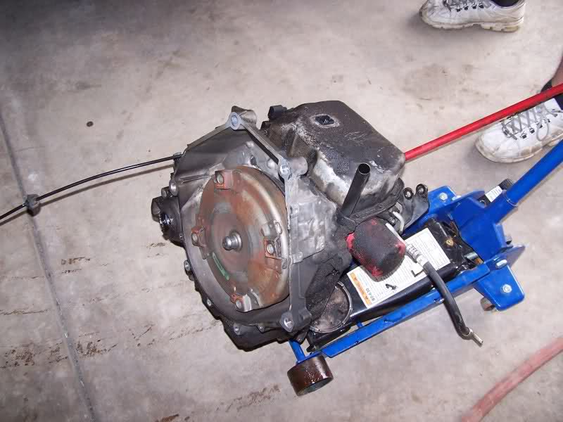

Well the auto ***** is on its last leg so im swapping in my manual *****. I bought the transmission last summer and me being the lazy person I am, Im just now starting to get it swapped in. I will update this post as progress goes forward. I will be doing the actual swap this sunday

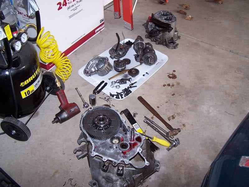

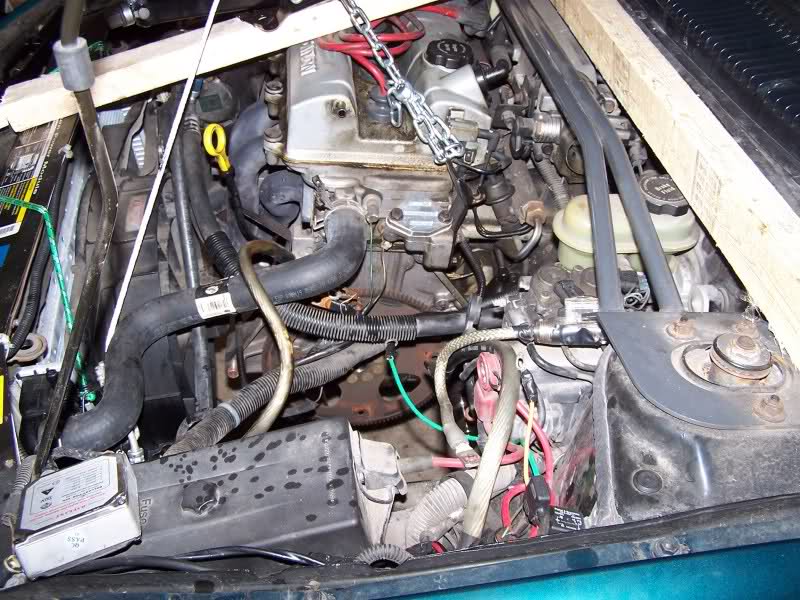

1. Transmission all disassembled so I could get the diff pin welded.

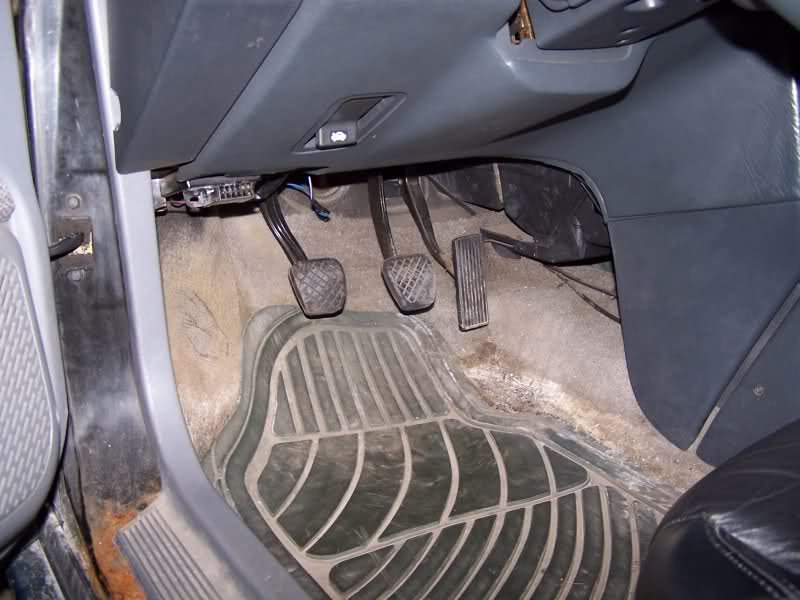

2. Brake pedal trimmed to fit the manual pedal cover and clutch pedal installed.

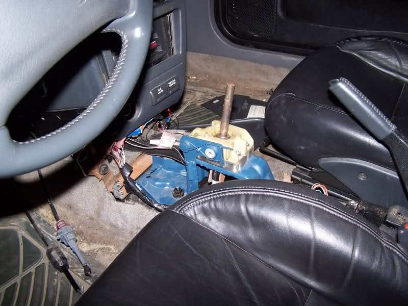

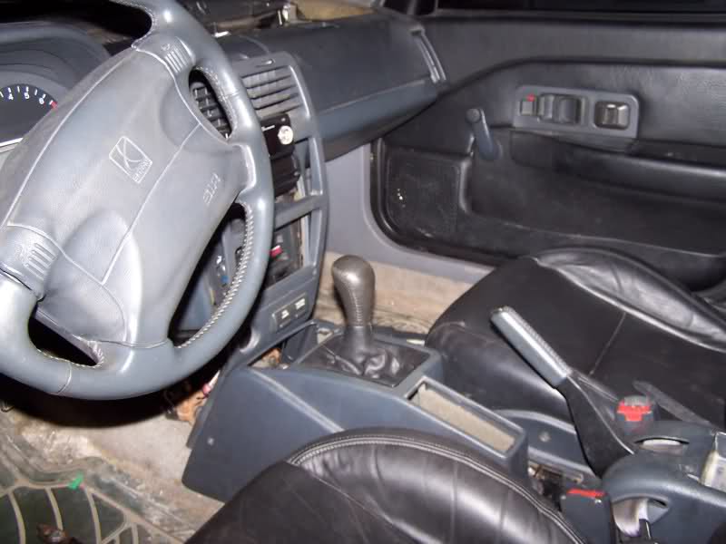

3. shifter installed

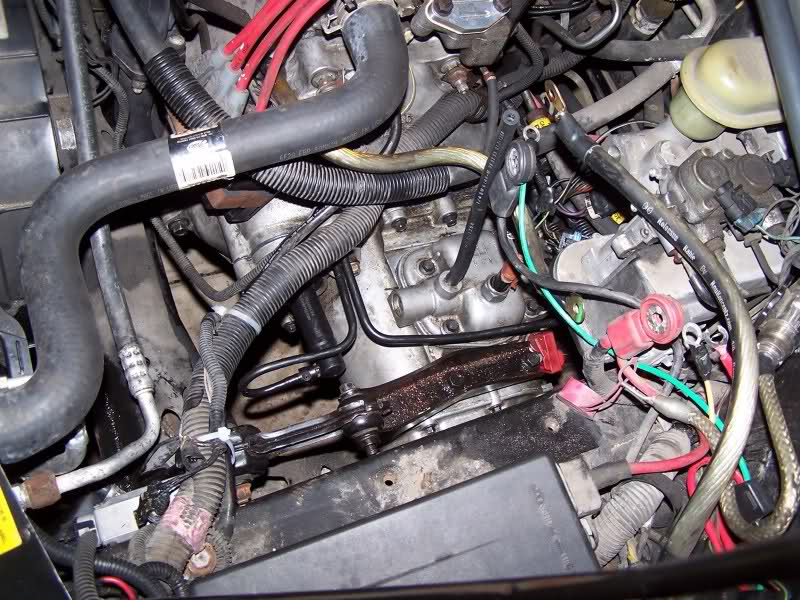

I just got finished putting the ***** back together a few minutes ago.

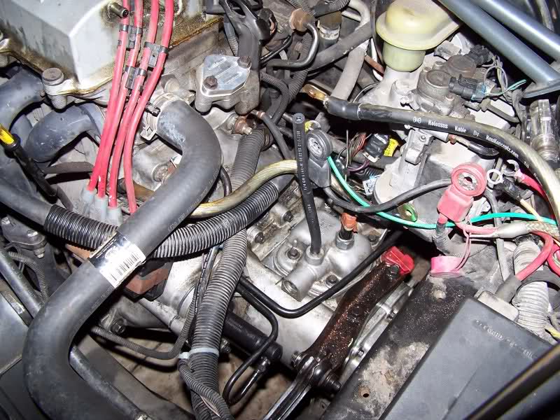

Its in finally. Started at 8 am and didnt finish till like 10pm. This was a ***** to do, but its well worth it. The flywheel is a Fidanza 8lb one, stock lifetime warranty clutch from Advance auto and the transmission has a Phantom Grip LSD with welded diff pin.
I still gotta get a clip for the slave cylinder that I didnt have and then put the battery and intake back on and I can drive it.

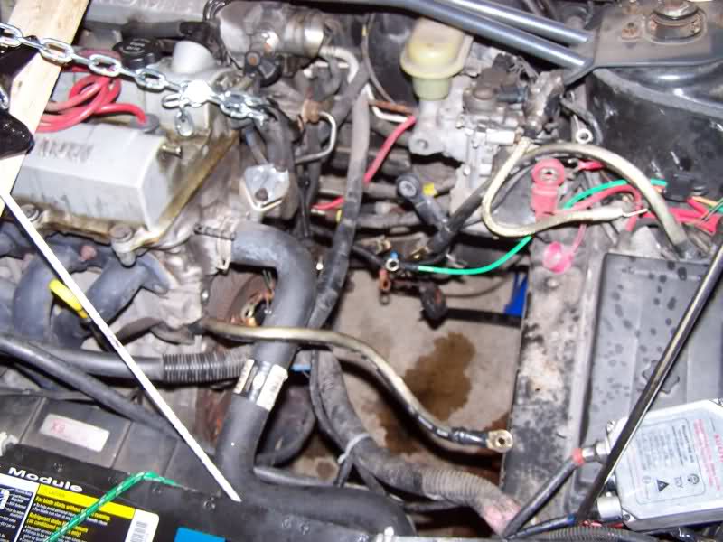

flexplate

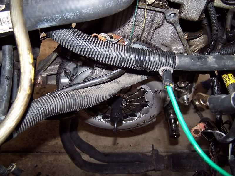

flywheel and clutch installed

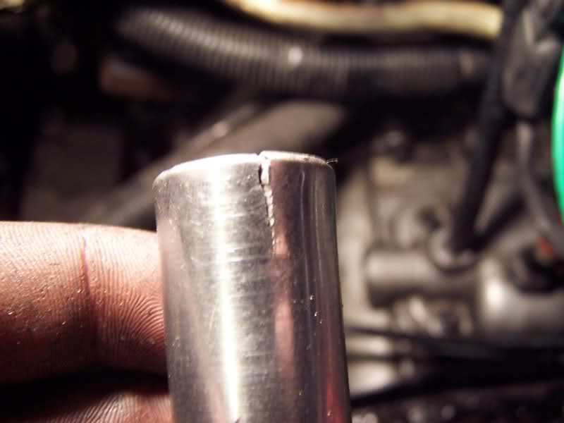

managed to crack a 15mm snap on socket with a breaker bar.
new ***** //content.invisioncic.com/y282845/emoticons/smile.gif.1ebc41e1811405b213edfc4622c41e27.gif
shifter.
if you broke a 15mil, you are putting too much torque into the bolts, or you have a really shitty socket set:fyi:
broke it trying to get one of the ***** bolts out //content.invisioncic.com/y282845/emoticons/fyi.gif.9f1f679348da7204ce960cfc74bca8e0.gif
and I dont think snap on is shitty.
I have never broken a craftsman, and i have put 3ft of breaker on a 15 before:fyi:
