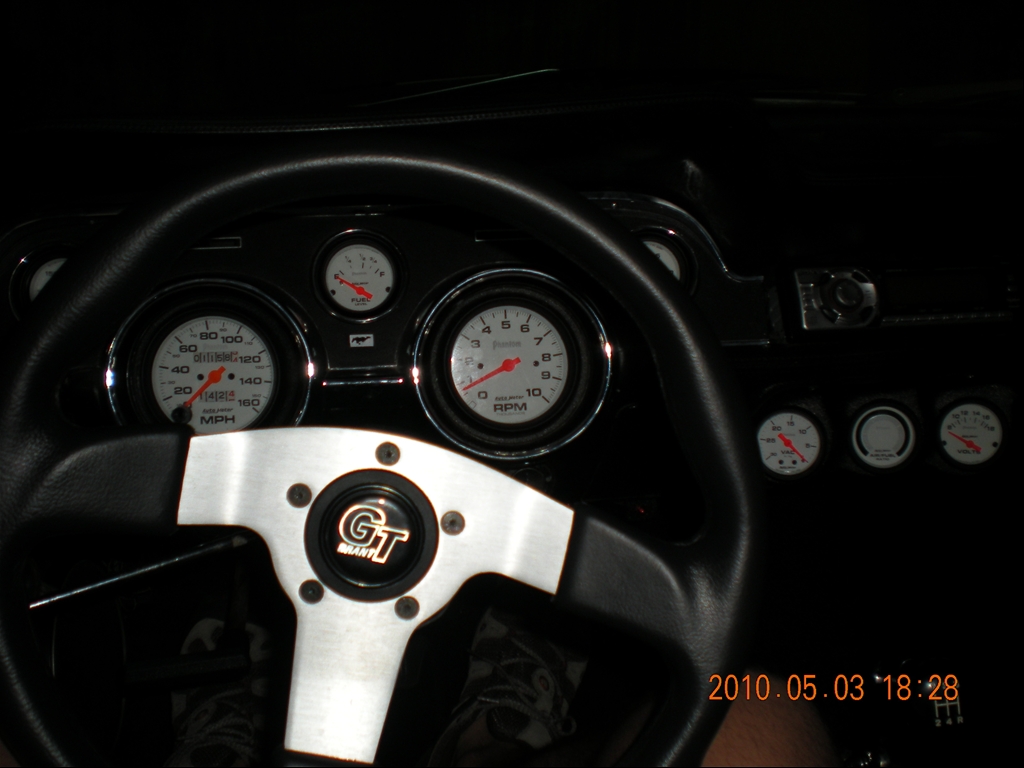

Custom build the stuff yourself. You'll save a shitton of money. A set of autometer gauges and bezel all built up for my car is 1100 dolalrs. I paid 300 for my gauges and i only took a few hours of work to modify everything.
I wish I could find some sorta adapter rings for my 80 ***** AM The holes are a little too big for standard gauges
Do what I did, if you loo kthe holes are much bigger than the 3 3/8 speedo/tach I used. I just bought some 1/8th abs plastic off ebay and milled them with a dremel to make them fit. Looks great and it was easy/cheap
