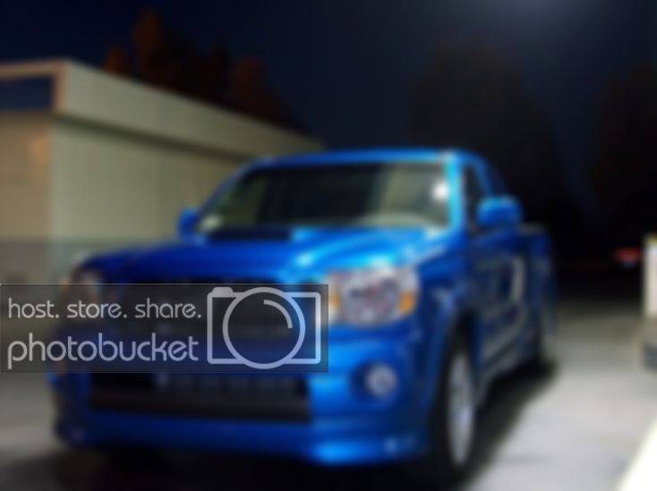

dude those trucks are badddddd asssssssssss, i love em....whenever i decide to buy a new truck ima throw a down payment down on one of those
It's a smokin deal. Power everything, steering wheel controls, telescoping steering wheel, 6 spd manual transmission, 4.0 V6, Bilstien Suspension(holds .9G's in the skidpad), low 15 sec 1/4 miles, all for 23K.
