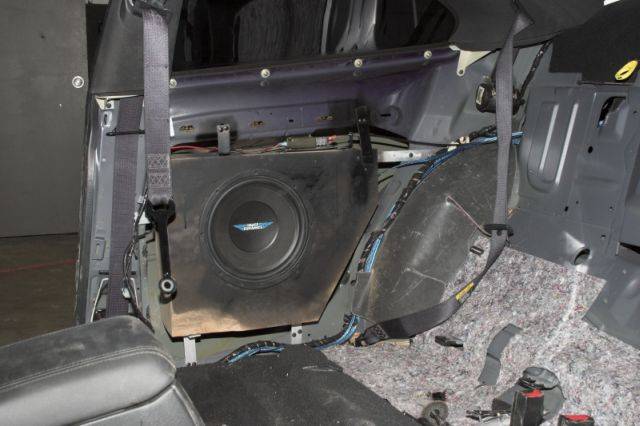

So I have decided to change my setup from 1 12" JLw3 in the trunk to 2 10" IDQ subs in the side panels inside the car. I hate how I have the gas tank blocking me from the sub in the trunk, I dont get much output with all of that in the way. Here are some pics of my current setup and what im switching to.
Before:
In the works, 2 10's in each quarter panel:

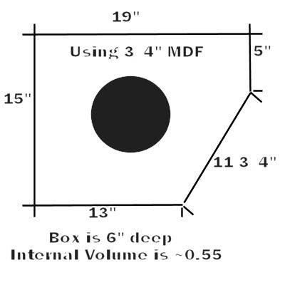

Box Dimensions:

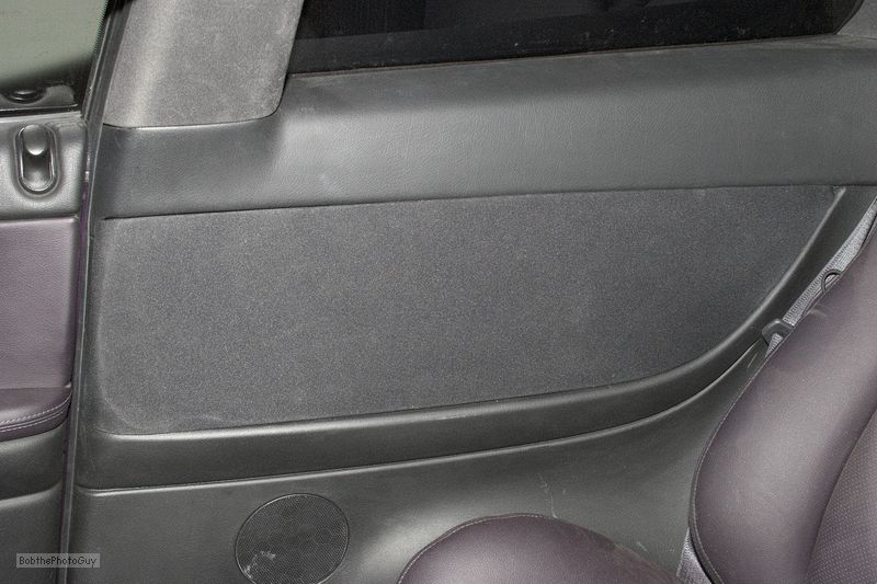

Pic with armrest on, modified so the sub can breathe

Nice looking install. Also very stealth. Can't steal what you can't see.
You would benefit from a bit more power, but I understand working with what you have.
Nice looking install. Also very stealth. Can't steal what you can't see.You would benefit from a bit more power, but I understand working with what you have.
Ya more power as in more power from my amp or the overall subs? I hear these IDQ's are very high quality. Im sure this will be a step ahead of my current setup. I am not looking to go huge on my system but this should sound great.
