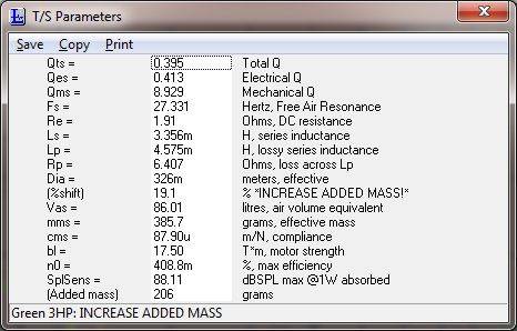

My new custom modded 3HP's
All the numbers you have, lol.

Very nice, those were built well. Perfect for the car environment, gonna be very loud.
I'm happy with the t/s for sure. Should do well. Polishing up motors now!
