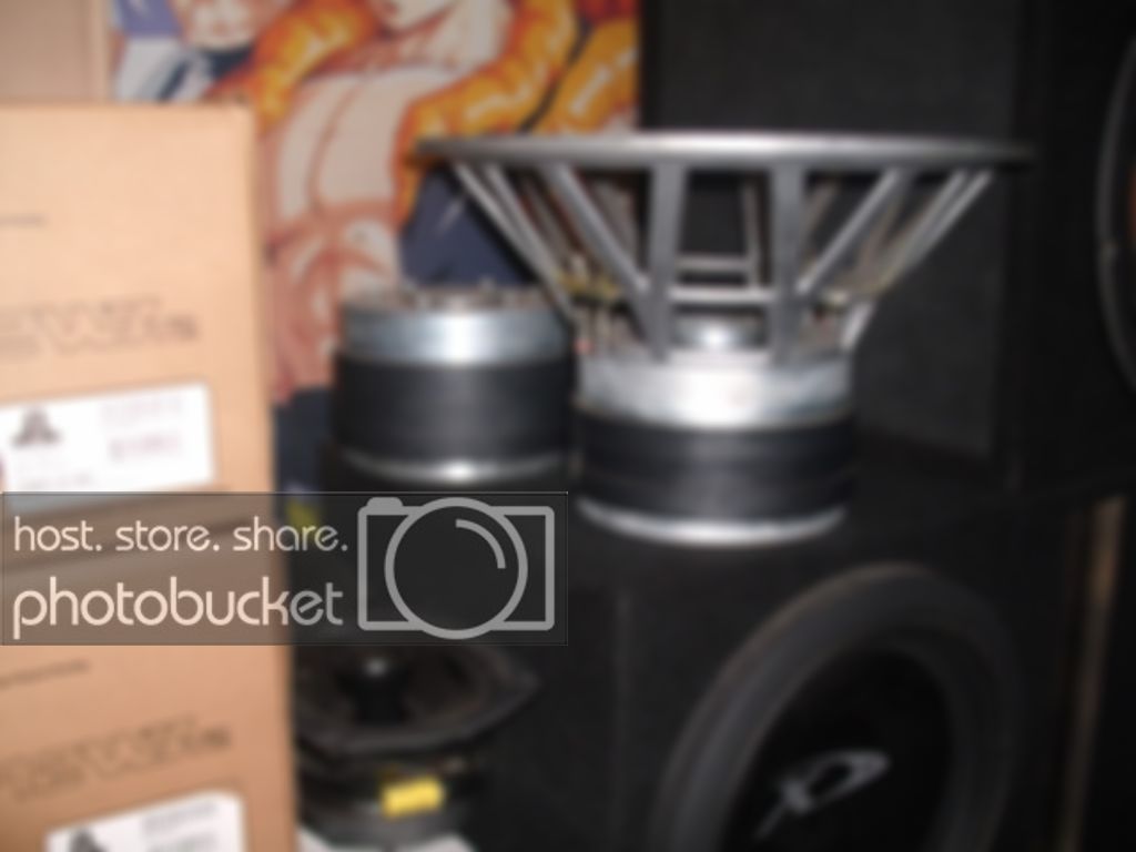

My new Custom 10" built by Resko1
CSP= 4" coil motor. The one used for this driver is more or less a RE HC motor which is very similar to a 3hp but with a tighter gap. Nice job with the sub. Looks good!
double post ftl
35mm top-plate 53.34mm WW so
53.34 - 35 = 18.34mm/2 = 9.17mm one way linear Bl (I dont groove on industry standards for how much motor force is enough, 100% or none baby lol)
19.67 one way 70% method as i figure it
Thats about what I figured... although you are much more generous with the xmag figure...
A 62mm+ winding height would be better, but we can't always get what we want.... personally, I would have used a 68mm copper coil and made a 15" sub... //content.invisioncic.com/y282845/emoticons/naughty.gif.94359f346c0f1259df8038d60b41863e.gif

Adapter plate is 0.5".
Top plate is 1.18".
I think it was verified by Dave Moore that this was in fact a CSP of some sort. Either way this motor is very nice.

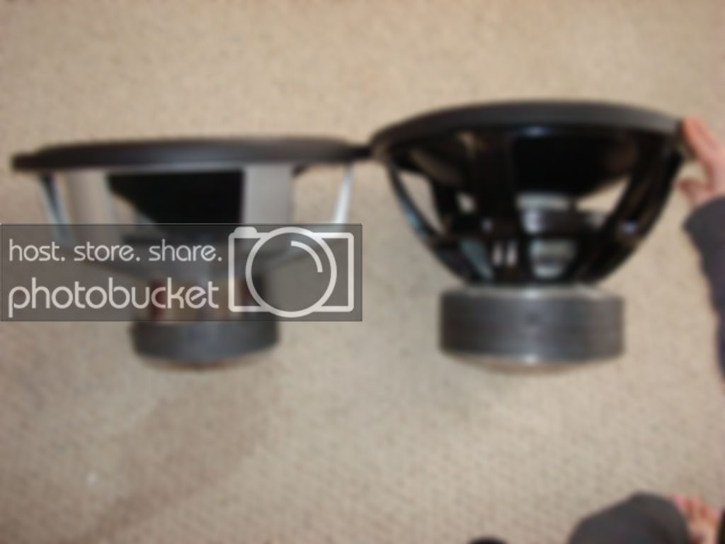

Edit:
These are my 2" top plate motors...
