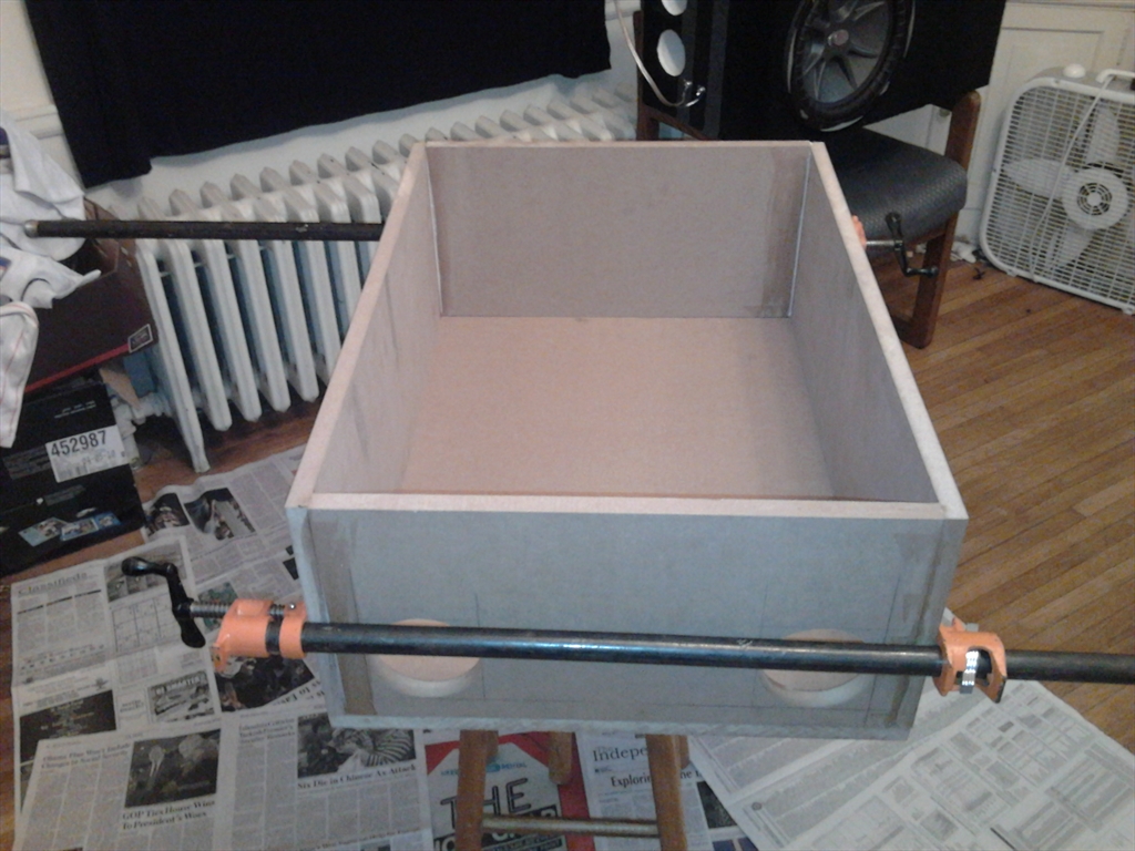

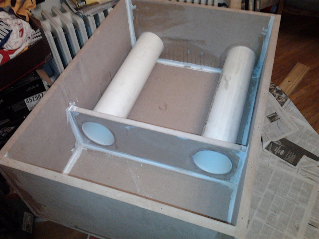

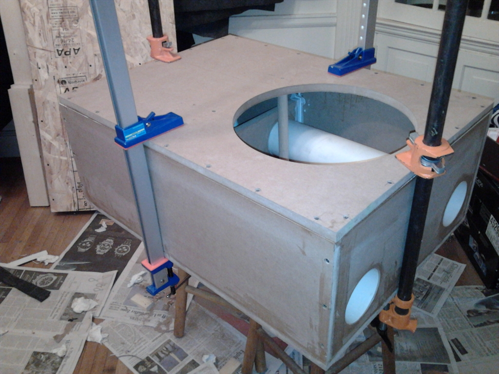

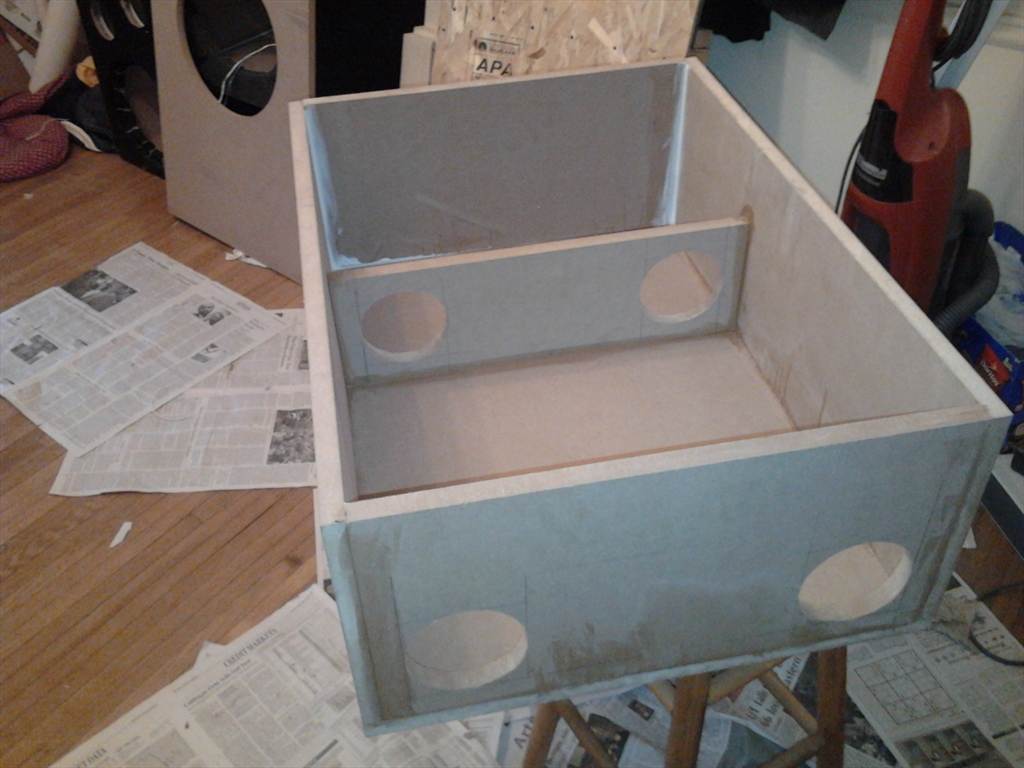

I have never shared any of my builds on here so I figured I would share my most recent box build. Its nothing too special though.
The goal was to make a good sounding daily ground pounder to make it easy to resell locally.

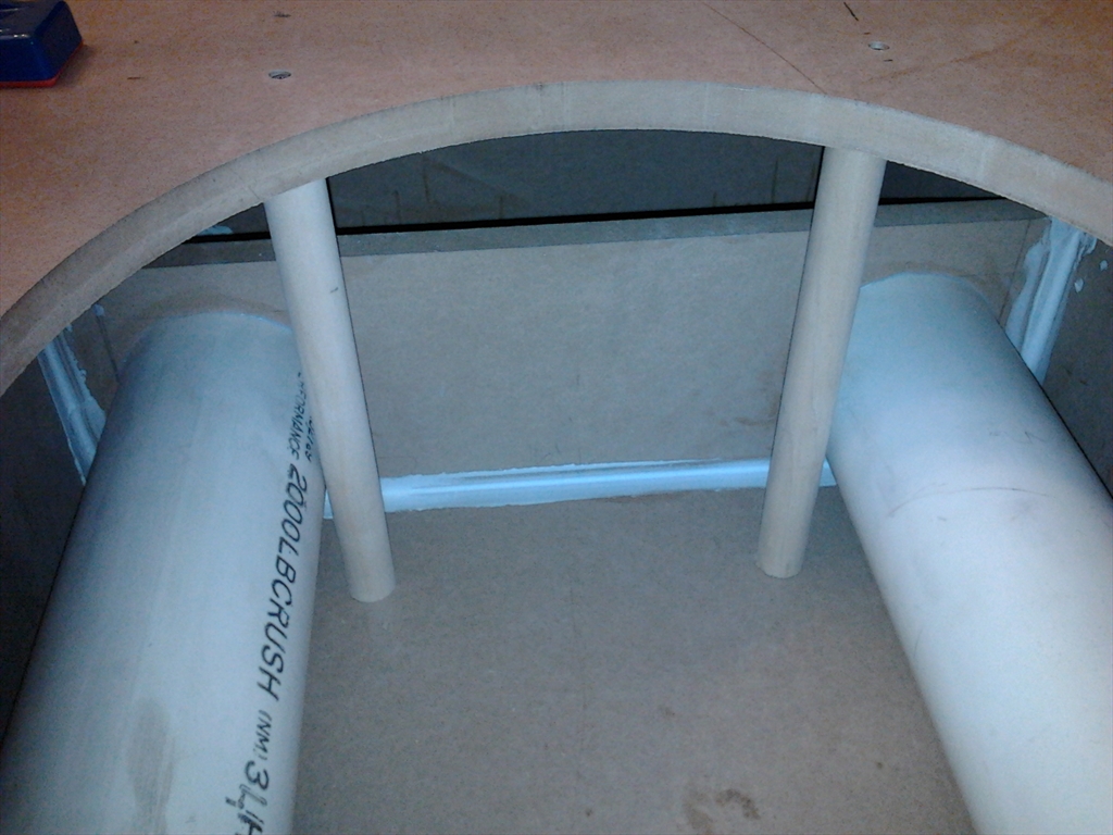

It comes out to 2.98 cu/ft tuned to 31.66hz. It sounds great and plays well into the mid to low 20s. The sub is an MTX Thunder 8000 15 svc 4.
On a sidenote, I picked up these clamps halfway through the build for stupid cheap. You can get them for $10.40ea before tax if you use the 20% off coupon thats distributed practically everywhere. Oh, and they have a lifetime warranty. http://www.harborfreight.com/hand-tools/clamps/58-1-4-quarter-inch-aluminum-f-style-bar-clamp-92490.html
