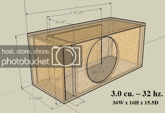

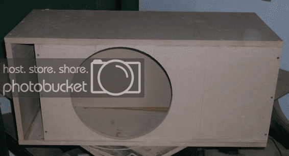

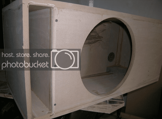

setup:
JBL BP600.1 (700+ watts @ 2ohms)
15" Mach5 MAW15
3.0 cu ft enclosure tuned to 32hz
I would like to thank crzystng for the design and SPY for the build
great job guys!

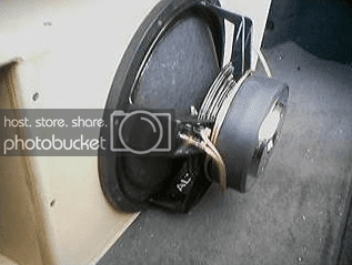

I have an 07 Altima
stock speakers
this sub goes down real low (I missed the low-lows) and gets very loud (pretty good SQ too)
halfway through "Late Night Tip" I felt odd...like my ears were gonna pop lol
second loudest single sub setup Ive owned (15" RE SX is the loudest)
maybe...lol
sub weighs more than 25 lbs!
//content.invisioncic.com/y282845/emoticons/eek.gif.771b7a90cf45cabdc554ff1121c21c4a.gif
try one over 75 lbs //content.invisioncic.com/y282845/emoticons/frown.gif.a3531fa0534503350665a1e957861287.gif , now thats a ***** to try and mount vertically while the box is inside the vehicle //content.invisioncic.com/y282845/emoticons/crap.gif.7f4dd41e3e9b23fbd170a1ee6f65cecc.gif
