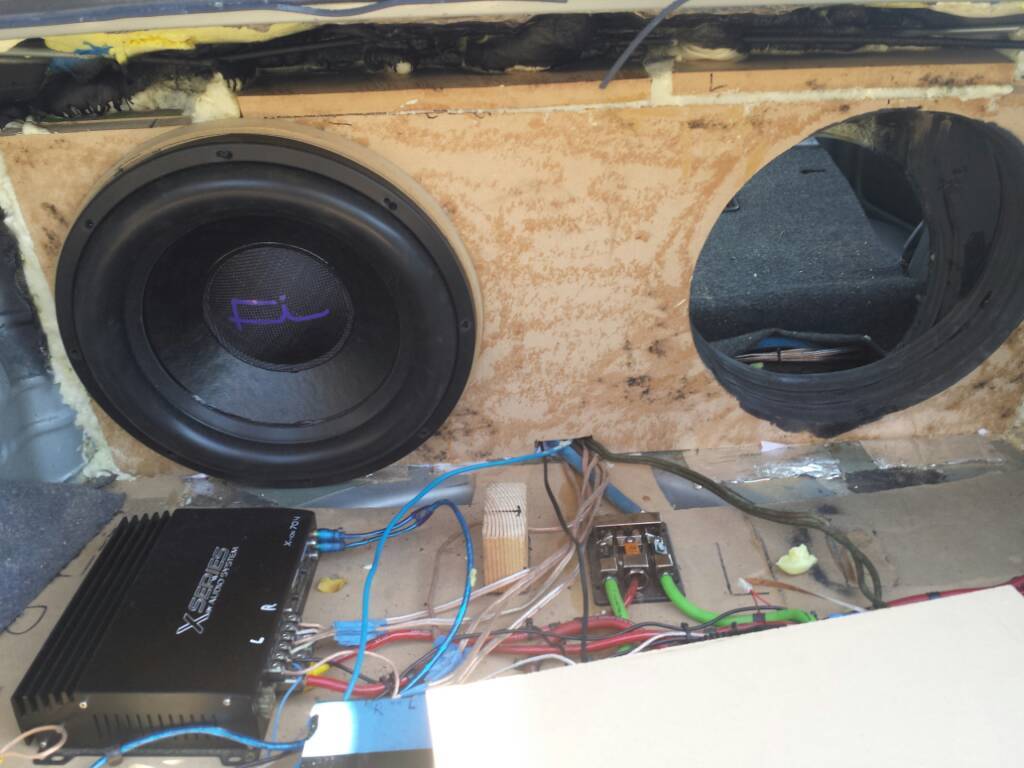

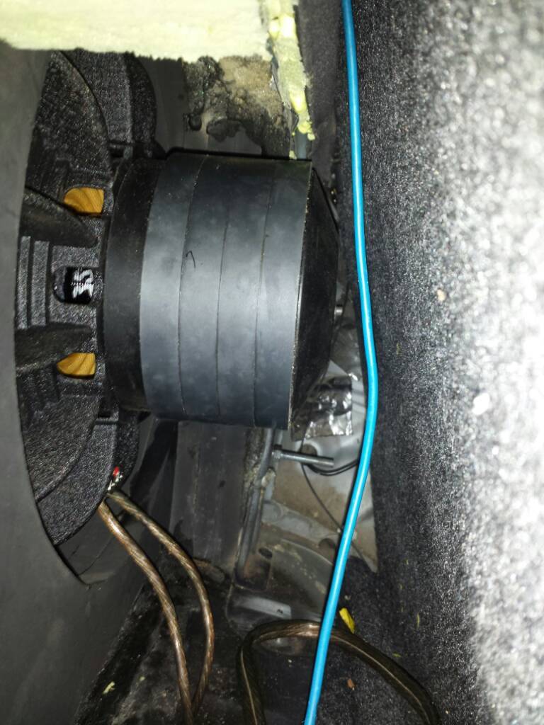

Got the first 15 in the car today after drilling new holes for the gasket and gluing the spacer to fit correctly. Its on the same Cerwin Vega 1k at 2ohms right now till the 2nd gets here. Turned it on. Hey this sounds really good but where are my lows. Open up the laptop-dsp. Ah yes. Who needs a SSF? Notttt me. Take off eq and SSF. Oh. OH HO HO HO. There are my lows.
Despite issues. Sub is fucking dope. Got Tracking on the 2nd one today as well.

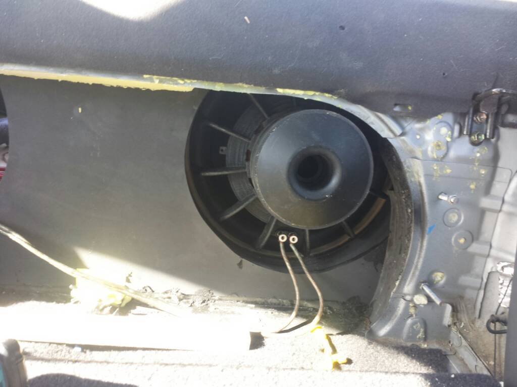

Right side is backseat. Yea. Tolerances...

They have 34mm of excursion and are rated for 600W@20Hz. Its probably seeing 600 watts at 20hz on a odb signal rn. Maybe. I sealed the hole as well. the motor is facing the cabin so ill def be listening for tink tink tink.

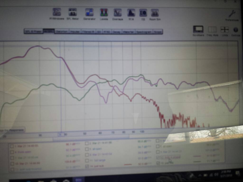

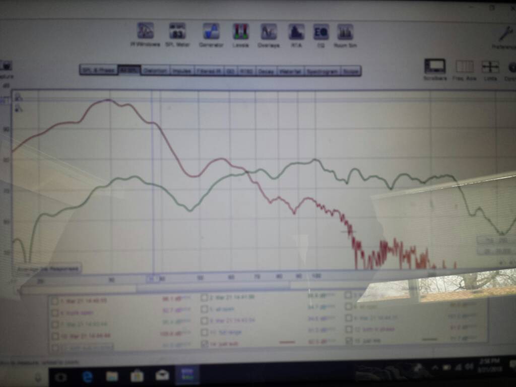

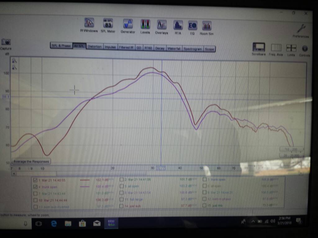

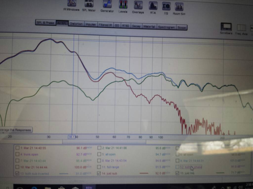

Response pics with only one sub in and hole sealed.
First pic. Pink is trunk open.
Second pic. Red is sub. Green is Sls 10in midbass in kicks.
Third pic is them out of phase (same time alignment same polarity)
Fourth pic is them in phase. Same t/a, opposite polarity because of inverted sub direction.
