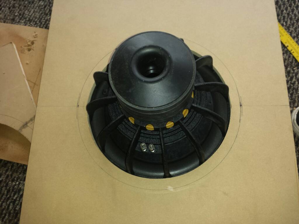

Sub gets here roughly a week later. CF dustcap(neat), Gasket holes are atleast 1/4 in off from the basket holes and the gasket doesn't move or come off. So i have to drill new gasket holes. Wonderful.

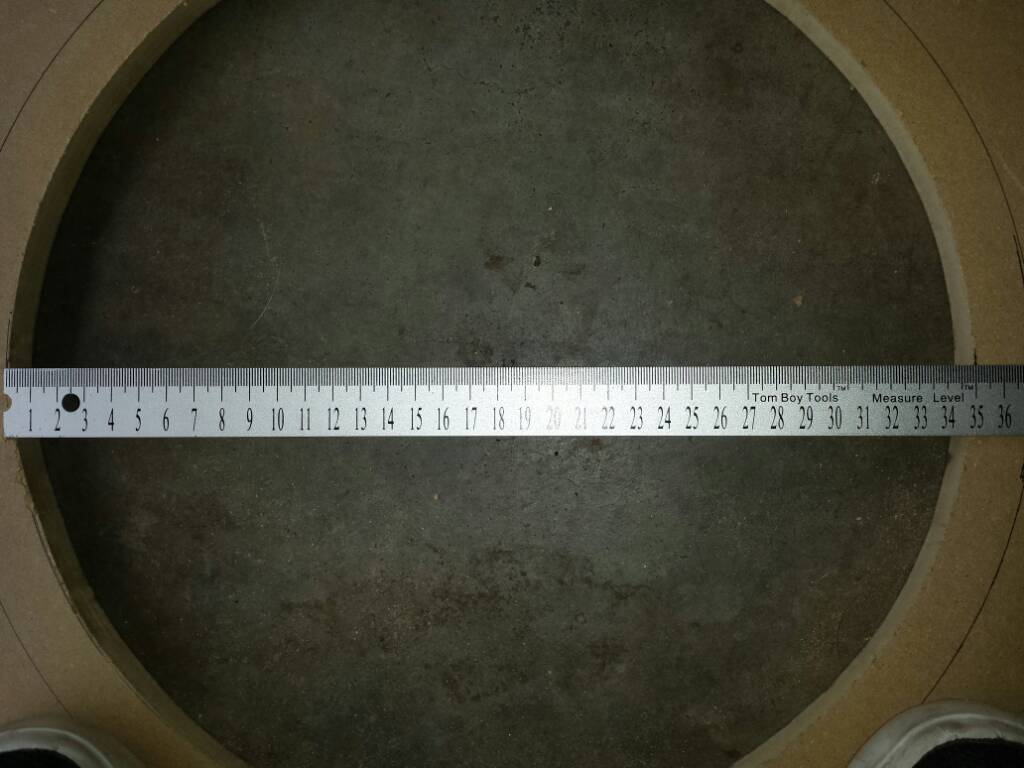

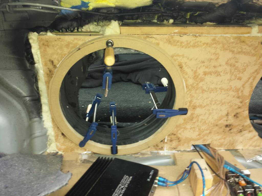

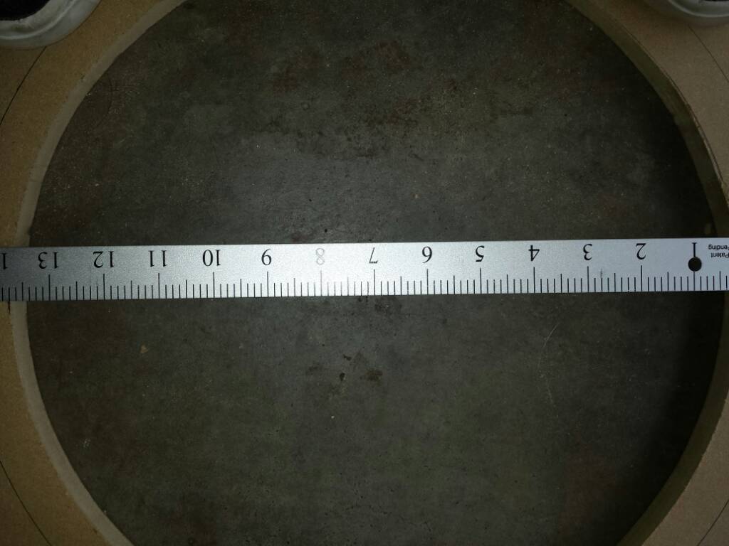

So i say screw it and i want to hear atleast 1 sub so i go to install it. Oh look, my 5in thick baffle with perfectly set up cutout diameters...are atleast 1/4 in off... so my screws don't screw into anything..
So i remeasure everything. Just to check. Nope. Their specified inside cutout diameter is WAY off.

Sadly, Fi and Acoustic Elegance(being WAY more expensive) are the only two companies that make IB Specific subs. I think i can fix these issues(short of wondering where the hell my second sub is), by adding another 3/4in layer. Its way thicker than i wanted but the baffle was built in the car. There is no getting it out so i have to adjust. Its only 3 screws that wont grab if i move to the right in the hole. So i should be able to make it all work plus Shag on top of it all and the weirdness shouldn't show.
Also in case you were wondering actual cutout vs stated.
Stated = Outer 15.625
Inner=14.125
Actual= Outer Roughly right
Inner= 13.7795
you dont need to make an entire baffle, just a circle like 1-2 inches of width. depends but sometimes you can make it look good

Pic proof
Sent from my SGH-M919 using Tapatalk
Honestly i think they musta given me some QC failure sub. Like hey hes complaining. Just give him SOMETHING and thus i got one with a CF dustcap and a fucked gasket. Or maybe he just rushed it himself. who knows.
