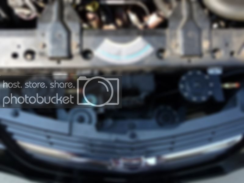

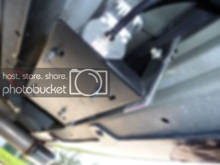

My main goal here was to have them pointing in the same direction. Fitting all 4 horns into the space I had was tedious. I didnt want any horns to be visible below the car, so I had to make sure the longest horn was mounted as high as it could go without affecting the hood closing properly. So I made some L-brackets to mount the 2 longest horns. The other 2 horns are secured by giant zip ties. The air valve is secured to a frame piece with bolts and lock-nuts. The best part is, I didnt even have to take the bumper off to install them!

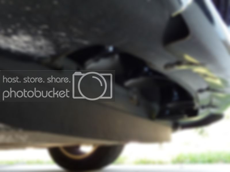

Underside view:
Here is a view from under the car. All horns are out of view.

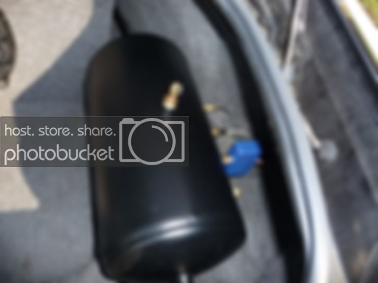

The air tank:
The air tank was another issue...I wanted to mount it where it would take up the LEAST trunk space. It took me a while to find the right spot where the mounting bolts would go directly through the trunk and not through a support beam!

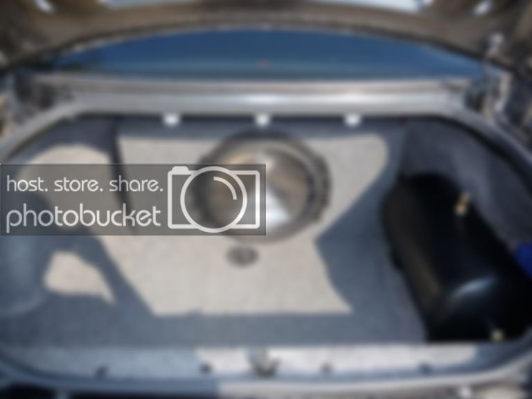

Another shot with my TC Sounds LMS Ultra 15: (now have FP12's)

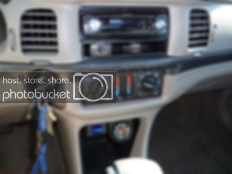

The air gauge:
I took extra care when installing the air gauge. I chose an Autometer gauge for reliability. I then wired in a switch that controls the gauge lighting as well as the compressor.
