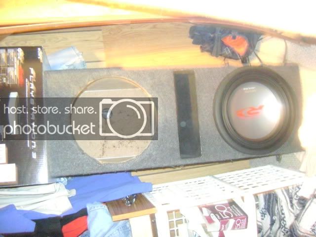

2 12" Alpine Type Rs SWR-1242D in a Dual Ported Box.
$80 for first Sub+Box $90-$140 depending if I buy it new or used and where. Hoping I can find it locally for under $100 or on ebay used for under $100. Starting to seem like I might be stuck buying it new for $140 on ebay then being forced to break it in which is gay. HEY I just answered every other sub title for the Subs didnt I? The box is 37in x 16in and each sub area is 15in x 12in with a 2in x 16in opening that leads to the port. The port is 3in x 12in. Brother mentioned that the subs might not be getting enough Air. Dont think he is right though...

Is that a prefab box? Looks a lot like some of the prefabs around here. I actually had one for a little while and it looks just like that one in your pic. When I got my subs out of the prefab and threw 'em in my custom built box, there was a world of difference. You may want to consider building your own.
Here are some things you should HEAVILY consider reconsidering..
1. Capacitor = NO, get a 2nd battery if you're having voltage problems. Try the Big 3 as well.
2. Prefabricated box = NO, have one built or build one yourself.
3. You don't need another 8" up between your seats, that'd be dumb. If your midbass is lacking, get a better component set or component amp.

1. Why do people view Capacitors as being bad? I do know it can save a battery...and if I get a 2nd battery wouldnt that be a bit too much trouble to go through? Your looking at runnings new lines from the Alternator to the 2nd batteries and finding a safe spot to keep the battery. Dont really think its possible to run a series circuit from the Alternator to 2 batteries...could be mistaking though.
2. Meh like I said not sure if its a prefab or not...even if it is how would a custom built box sound any different? They are the same basic principles arent they?

And it IS prefab. You can tell.

Capacitors are a bandaid for a bullet wound... They do NOT solve the actual problem of voltage drop and current draw. Also, building a box to spec for YOUR application is much better than those small volume, high tuned pre-fab boxes. And lastly, don't mix sub sizes. Adding an 8 sub up front won't so Jack shit unless you add a complicated network of crossovers which will be more expensive and time intensive setting up than just buying a quality component set.

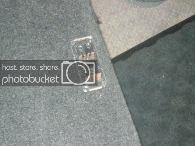

Wtf is this? Lmao...
The guy I got the sub+box off of mentioned something about what it was but I was cool ok w.e and just completely forgot about it until like 5 mins ago.

Looks like a distro block.. single 1/0 wire in & two 4 gauge outs? or smaller.. dunno.
Yeah that box is definitely a prefab. Building a box to the subwoofers specifications will make it sound much better. Some subs need more airspace and different tuning than others. Which is a reason prefabs are bad. They are all built fairly small and are built with no regard to tuning. So building a box specifically for your subs will let them sound the best they can. I gained a LOT of output going from a small prefab like that to my 6.8cu ft enclosure I have now.
