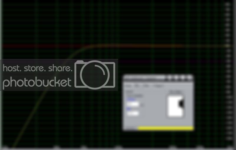

Here's what I was going for:
I put a plastic bag around the sub and put it in a full basin of water and found the displacement of the sub. Then I measured my trunk to see what space I had and designed a box to fit under the rear deck lid. The ratio of the box dimensions is very close to what WinISD calls "optimum." Good enough for me.

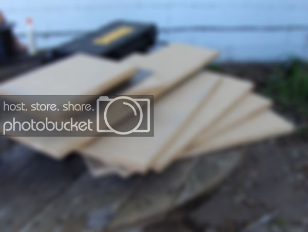

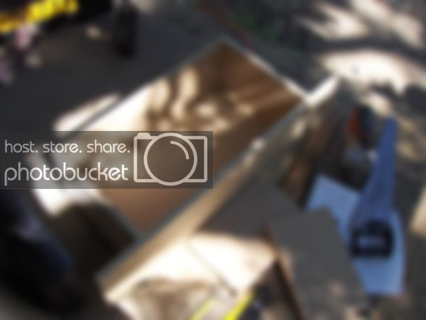

This is where ghetto comes in. I have no table saw, router, or jigsaw. A friend of mine lent me his circular saw and reciprocating saw. He also helped me cut the 3/4 MDF into the basic panels, and I took over from there.

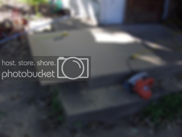

Can't cut straight with a circular saw without a chalk line!

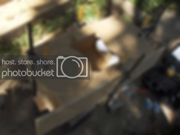

Turned out pretty decent. Just a few pieces not square, which meant some sanding later on.

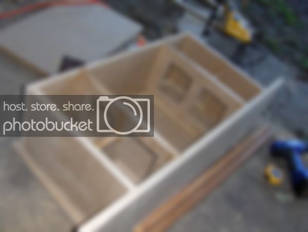

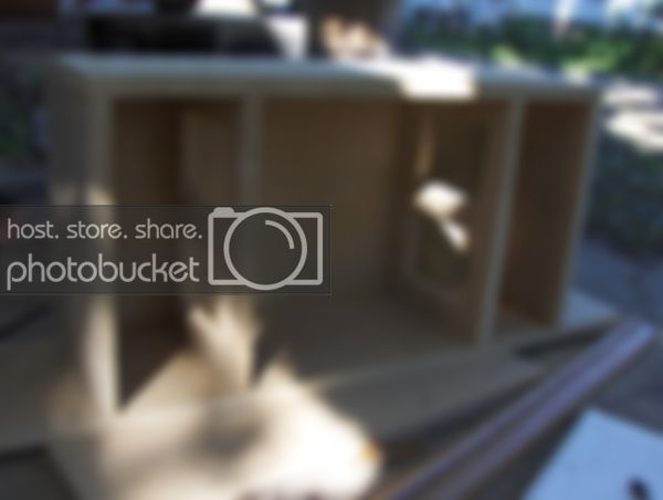

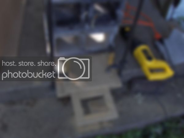

Cutting the windows in the braces with a reciprocating saw...I think I'm deaf in my right ear. I should have taken some ear plugs from work.
Braces done!

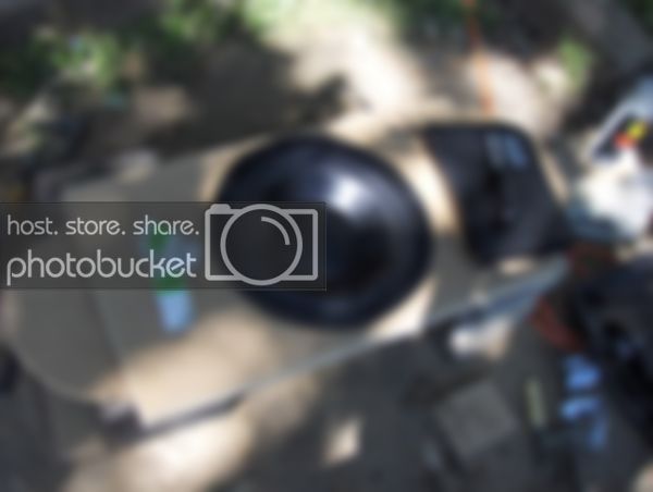

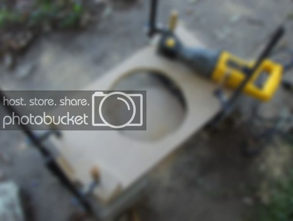

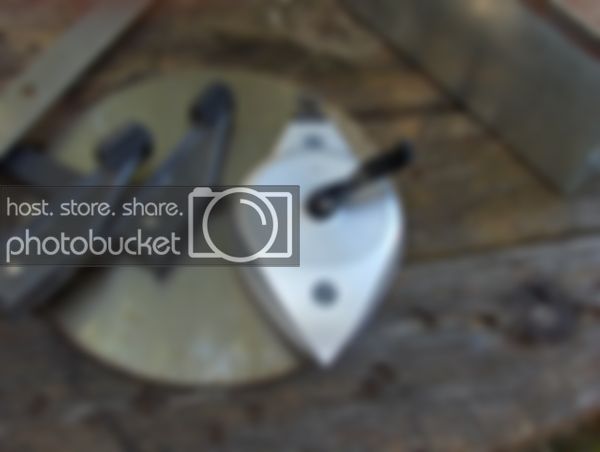

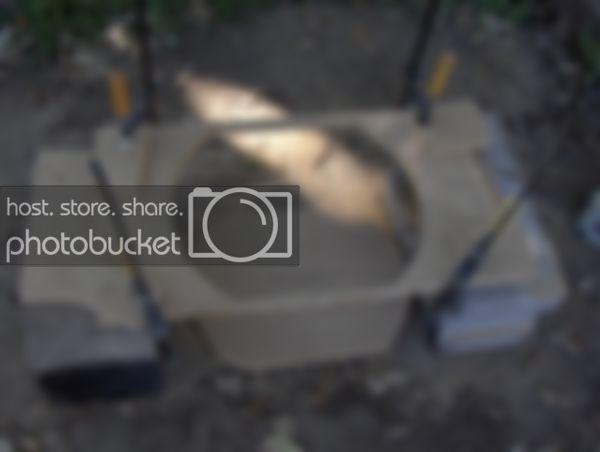

My attempt at cutting a circle with the reciprocating saw. Kinda sloppy...but it fit the sub, and that's all that matters
I decided to add more bracing...cause you can't have too much bracing

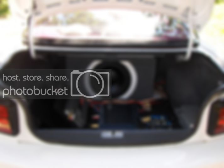

My car...

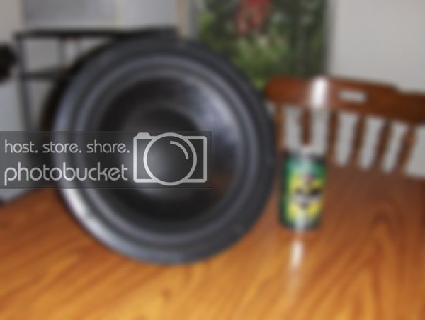

Test fit...yes! I used tee nuts and 2.5" bolts to bolt the sub to the baffle. It's a double baffle, totaling 1.5"

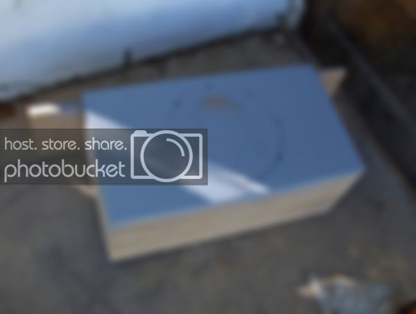

This is the decorative face I'm making...good so far
First 2 coats of primer on the face of the box. Rest will be carpeted.

I've never seen a sawzall cut the subs mounting!! Now I've seen everything. Suggestion: go to http://www.partsexpress.com and buy the router jig....it's wonderful.
I'm just a college student, can't afford a router. When I'm at home I use my dad's tools, but I don't have time to go home now or in the near future. Otherwise I would have used his tools. Tablesaw, router, etc. I had to deal with what I had, haha. Gotta start somewhere.
If you look at the second to last pic, I cut that out with the sawz-all too. I got better, haha.

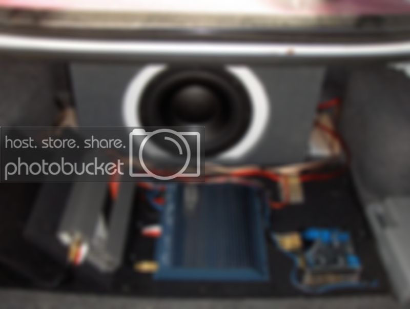

Okay, I got it done for now. I had to move back into a dorm room, so I had to get it in my car as soon as possible. Now I have to work in my friend's driveway if I want to get anything more done, haha.
I still need to build a new amp rack because that is my rack from my old setup. I have no trunk space currently. Then I need to carpet the rest of the box, and recarpet the decorative face. It was my first attempt.
