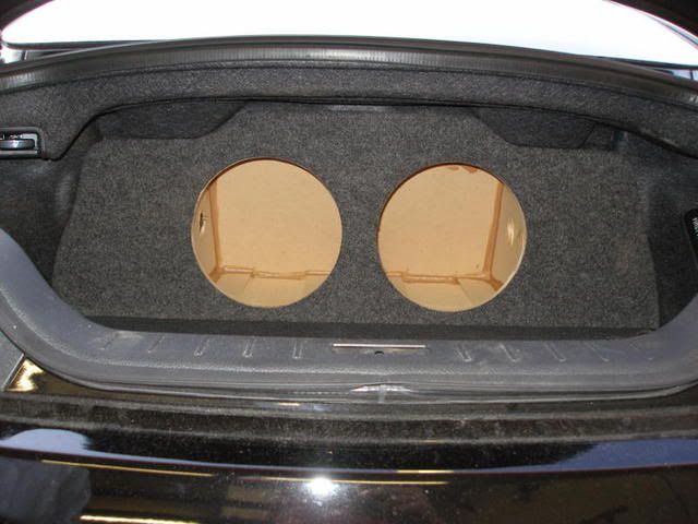

Another hole that needs to be drilled. Any locals from San Diego willing to help me out? I can pay you or something!
I first ordered this box as a single 10" only, now I am thinking getting another type r.. And I need someone to make a hole for me!
Picture;
Thanks!
.5cuft is a tad on the shy side for 10's sealed.
After you figure sub displacement you will actually be under .5cuft.
You *may* be better off cutting out most of the divider and porting the box for the 1 10 if that is possible.
Or if he has enough baffle space he can cut the hole bigger for a 12"er.
