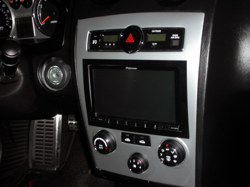

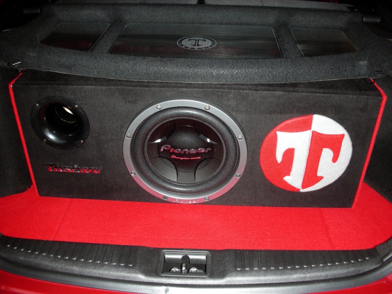

I don't have any pics of the build in progress but here are some almost finished photos. Still need to do a little trim work but it's finished for the most part. This past Saturday I hit 131.4DB with my single 12"! I was very impressed by that! links to pics below, tell me what you think.

Pioneer AVH-P4100DVD Headunit

(1) Pioneer TS-W307D4 12" DVC Sub in Custom Ported Enclosure
Audiopipe AP-10001D 1000W Class D Mono Amp (Sub)
Audiopipe AP-2004 2000W Class A/B amp (Front & Rear)

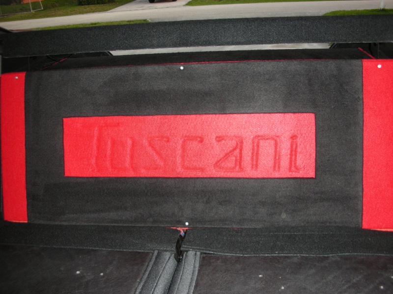

Thanks man. The piece you're referring to is the cover for my amp rack. All it is, is a sheet of 1/4" thick foam board! To get the letters resessed I first had to use a utility knife to cut each letter out! That took forever! Once the letters were cut I applied the felt. I waited for the spray glue to dry then I took the cap from a sharpie and worked the felt into the letter basically stretching it and wearing out a little as well. I repeated that process 5-6 times until I was happy with. Really easy to do, just takes a while.
