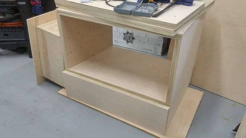

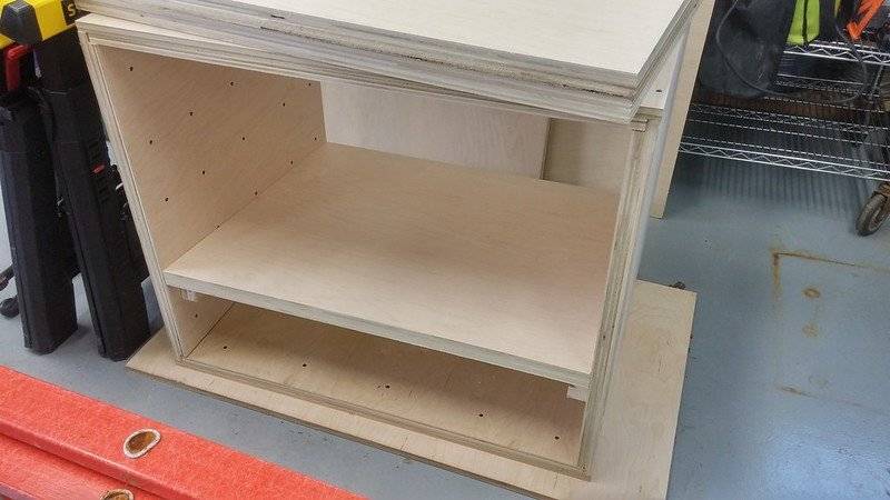

4th order wall, 4 cubes sealed, 11.5 cubes ported, changeable ports...

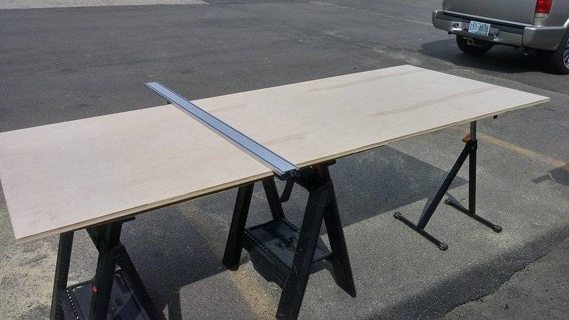

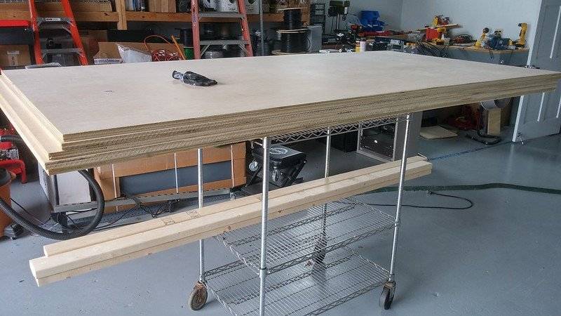

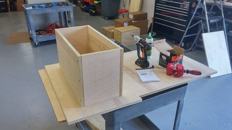

Picked up a Bora Saw guide, thing is awesome for quickly ripping down full sheets of wood with just a circular saw...
0604161531_HDR by Joebobclark, on Flickr

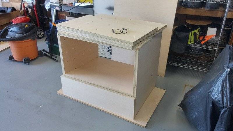

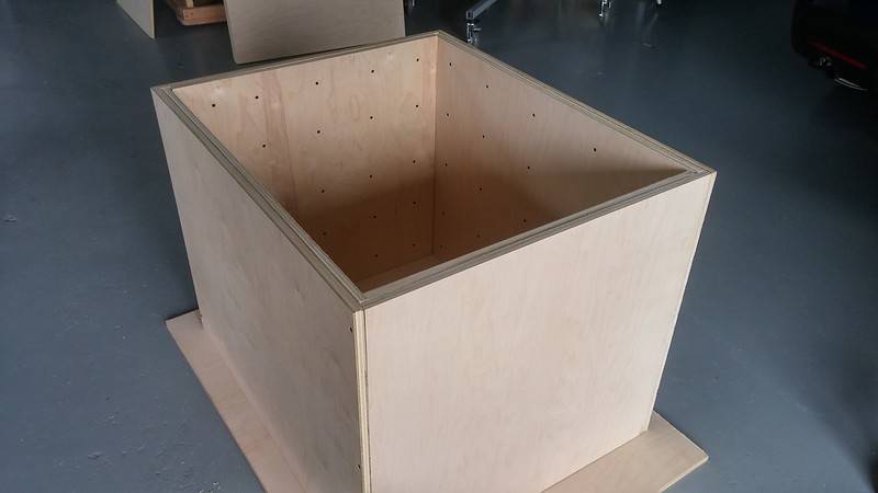

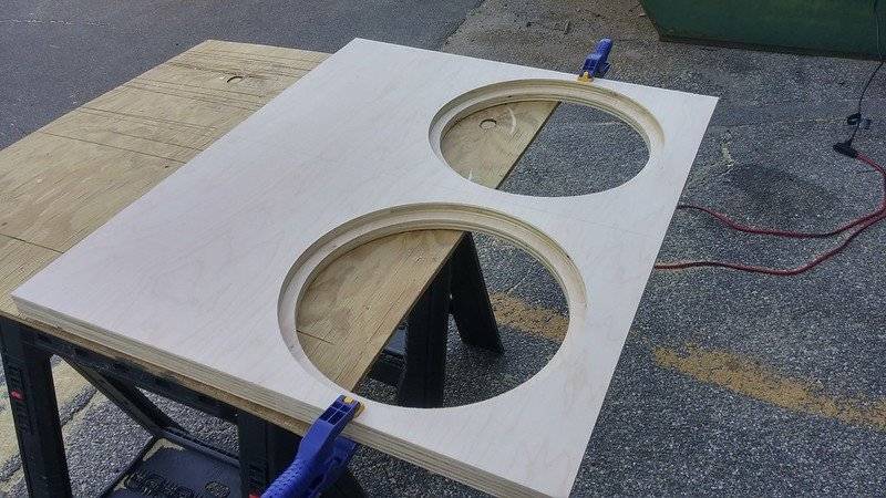

Dual layer on all walls and baffles....
0605161406_HDR by Joebobclark, on Flickr
0609161841_HDR by Joebobclark, on Flickr
0609161841a_HDR by Joebobclark, on Flickr

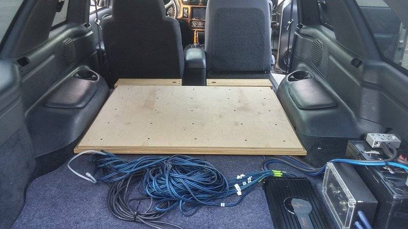

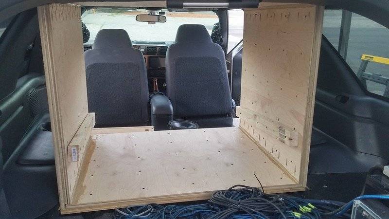

Upper back wall will be removable for access to subs...
0610161739_HDR by Joebobclark, on Flickr

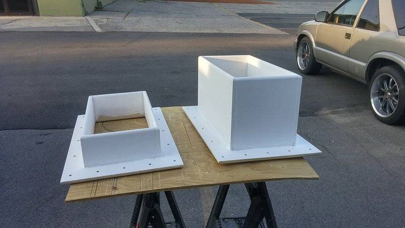

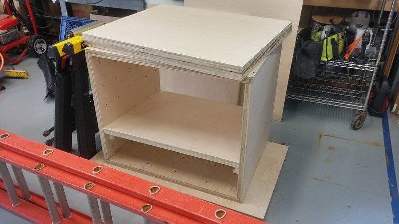

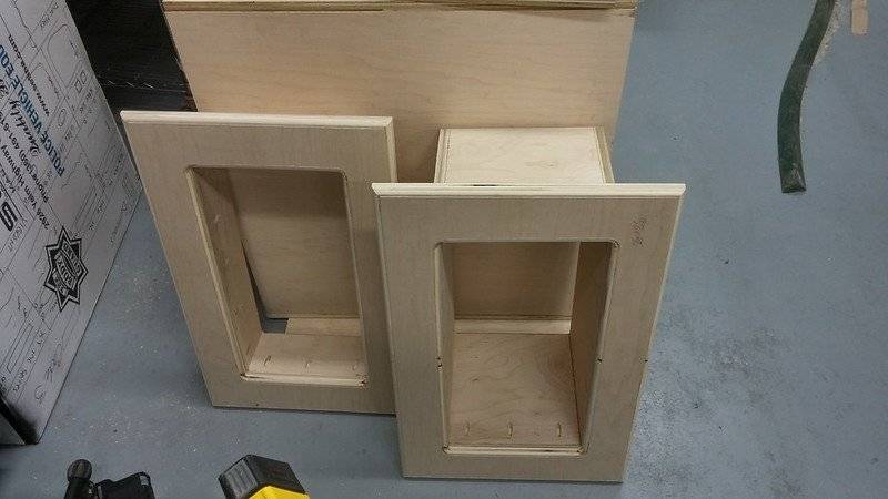

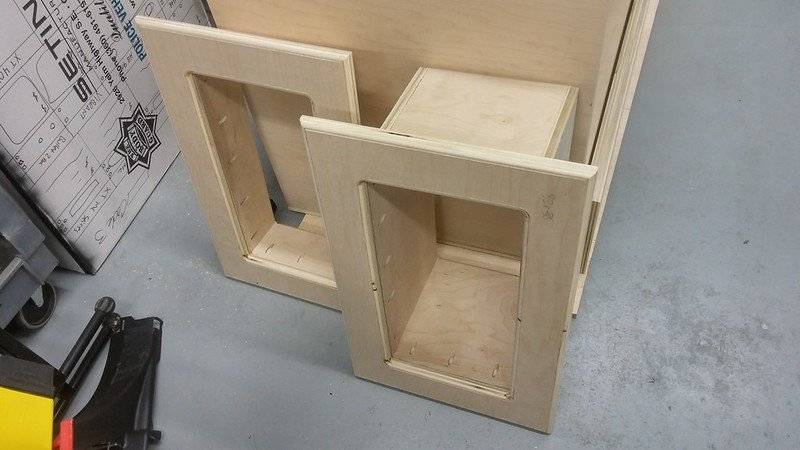

Built 2 ports to start with, one is tuned 44-45 hz and the other 52-53 hz. 200 sqin of port area on each...
0610161739a_HDR by Joebobclark, on Flickr
0613161832_HDR by Joebobclark, on Flickr
0613161832a_HDR by Joebobclark, on Flickr
Rounded over most of the edges and Kreg screw holes will be filled and sanded, then the whole port will be painted..

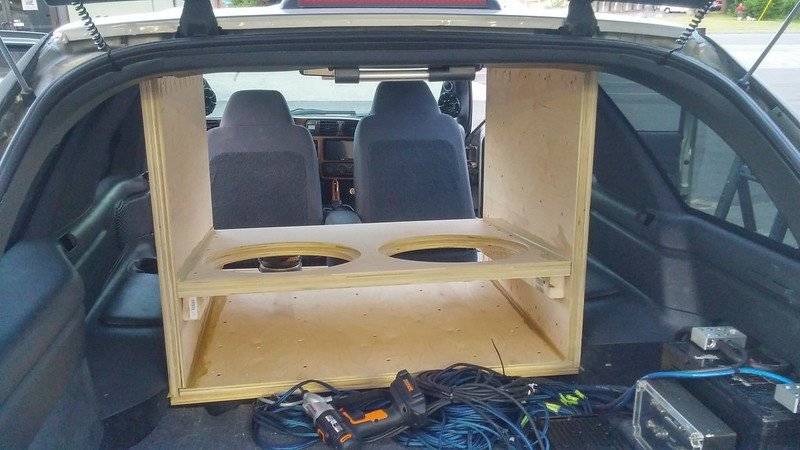

It wont slide into the Blazer, so I will begin building it inside the truck tomorrow.... More pics to follow!

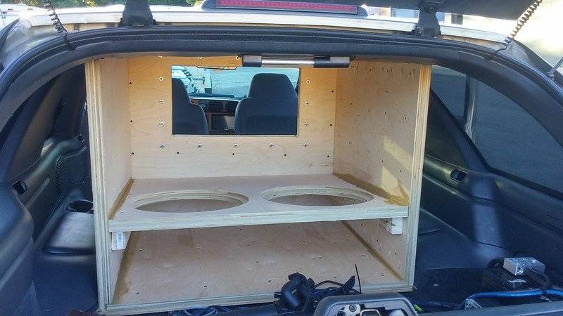

Not alot of time to work on it tonight but got the front loading wall on!
0621161918a_HDR by Joebobclark, on Flickr
0621161918_HDR by Joebobclark, on Flickr

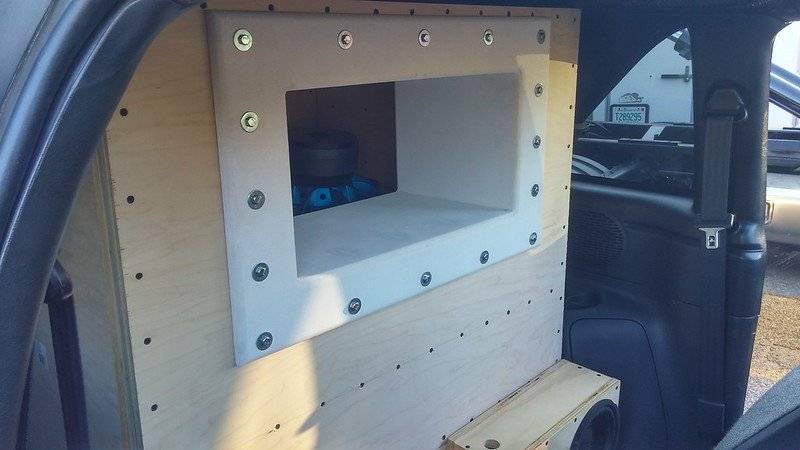

Painted the port in white for now, just to seal the wood. Plan to paint the inside of the box white with LED's in the future, but wanted to get it playing for a show/comp tomorrow..
0624161913_HDR by Joebobclark, on Flickr

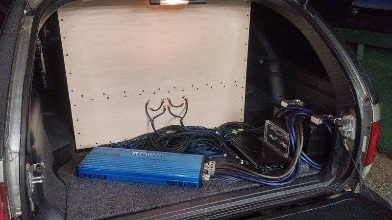

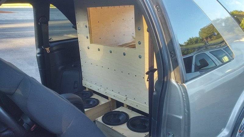

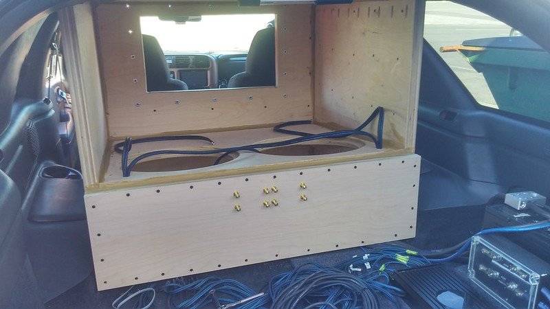

Wired up, ready for subs...
0625161637_HDR by Joebobclark, on Flickr

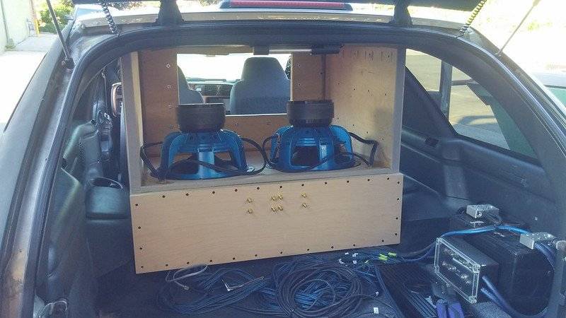

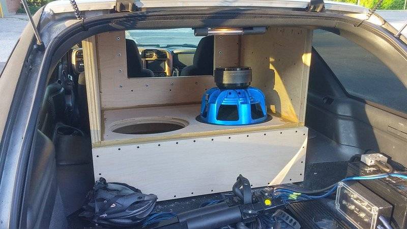

Subs in, ready to close it up...
0625161820_HDR by Joebobclark, on Flickr

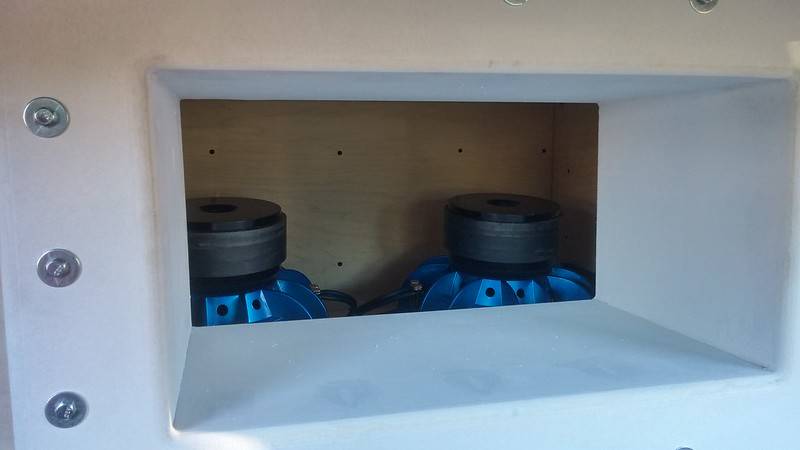

All closed up, port in, ready to go!
0625161844_HDR by Joebobclark, on Flickr
0625161843_HDR by Joebobclark, on Flickr
And as of 9pm tonight, its alive! Tuned by ear, very conservatively, it sounds great.

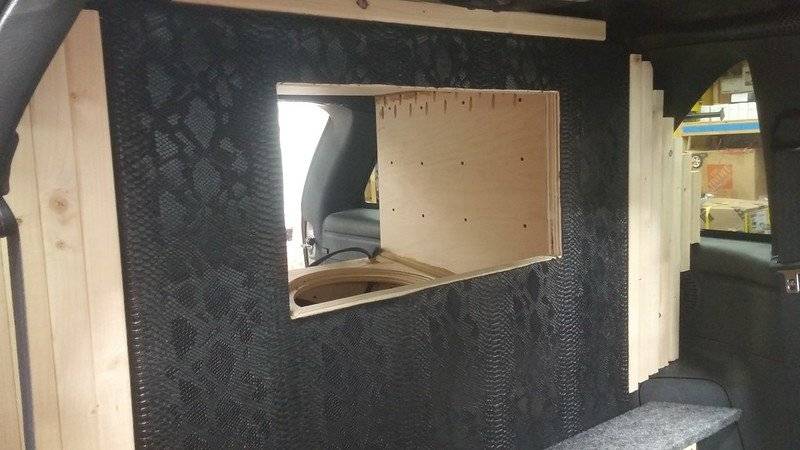

Little snakeskin vinyl for the front, to match my headliner (I redid it from the blue skulls to a black snakeskin when I started doing copper color in the truck instead of blue lol) and made some side filler/braces to seal up the wall.
0723162149_HDR by Joebobclark, on Flickr
Painted the inside of the box white and added some leds inside (will post pics once they are powered up). Painted the sides of the box and braces black so you cant see them through the windows..

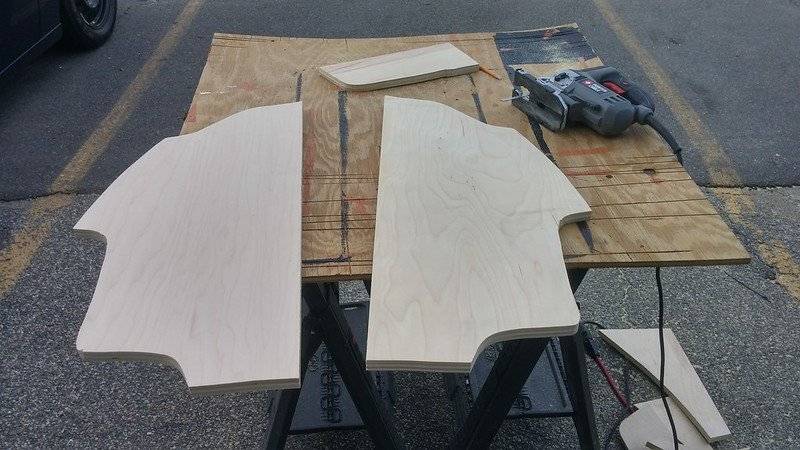

Made my front trim panels, still need to make the lower one to go around the 8's, but that one is going to be a pain in the @ss...
0724161857_HDR by Joebobclark, on Flickr

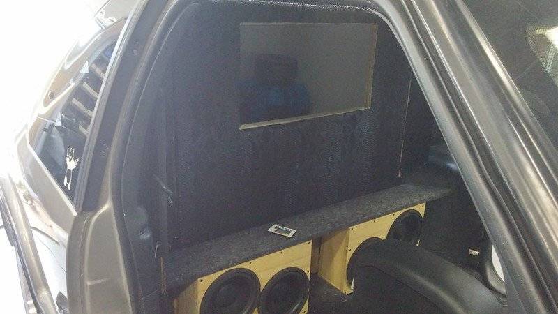

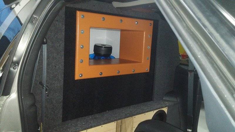

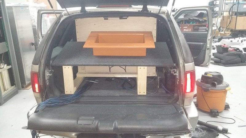

Trim panels carpeted up and installed, port painted a copper/orange color...
0724162031 by Joebobclark, on Flickr
And started on an amp rack idea... not sure if I like it or not yet, will see...
0724162136 by Joebobclark, on Flickr

Mine is 38" wide, 30.5" high and 29" deep external dimensions... It was supposed to be 32" high, but I couldn't fit it at 29" deep and have the front be where I wanted it. Im 6ft, and like to drive relaxed, so I set the wall back further to allow my seat where I want it since this is my daily driver. Mine wont slide in/out because of the height, built it in the truck.
It's doubled walled all around and double baffled, so internal after displacements leaves me right at 4 cu sealed and 11.5 cu ported. Easily could have gotten more airspace by building out over the wheel wells, or moving the front forward for more depth, just didn't really need it for my 2 15's. If you are going single walls with just bracing, should be able to get 5 sealed/13ish ported, I started with a bit over 20 cuft as well.

I built my ports at 200 sqin (20x10), tuned to 46-47 on the daily, and 53-54 for SPL. I haven't really played around with it yet, but I figured that would be my maximum port area and I could shrink it down if need. Metered the daily port, it was peaking at 36hz, did a 144.7 with a very conservative "by ear tune". Will have it back together tomorrow, and get it tuned with my o-scope. Hopefully, play around with it Saturday and see where my peaks are for both ports and get a meter on it at full power....
