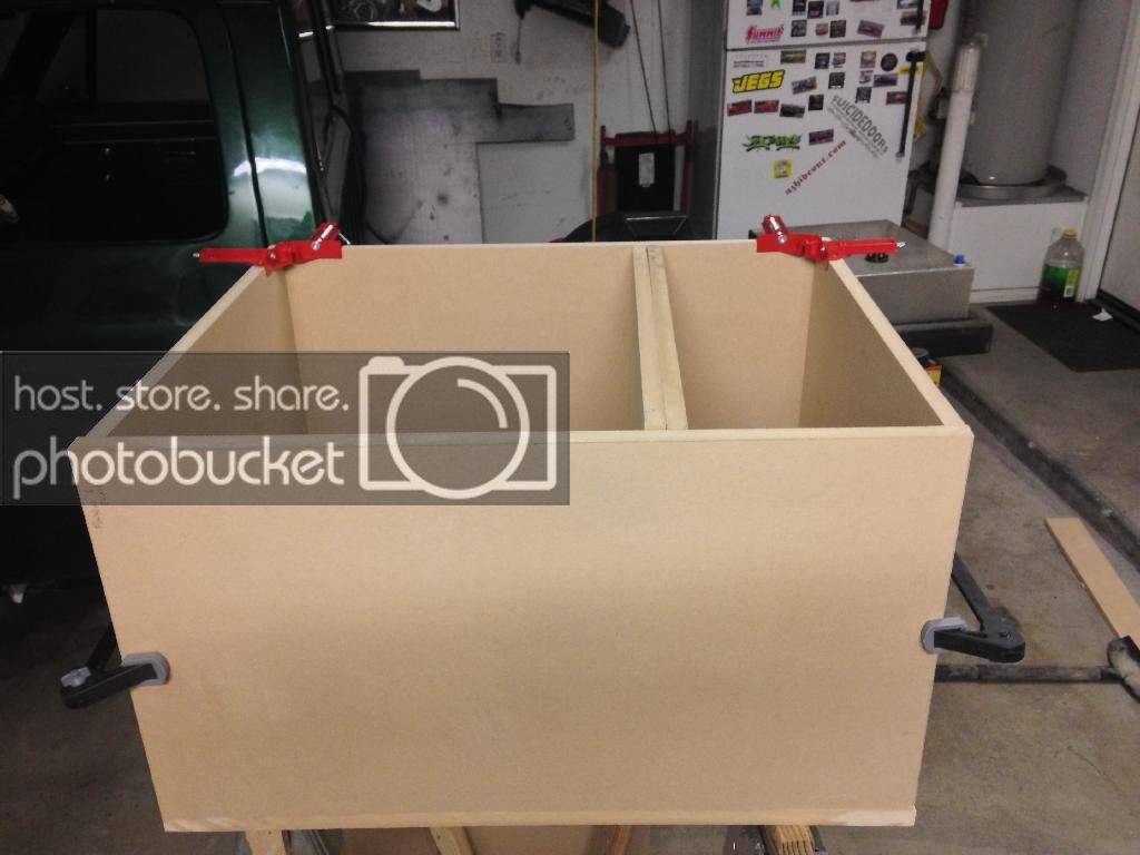

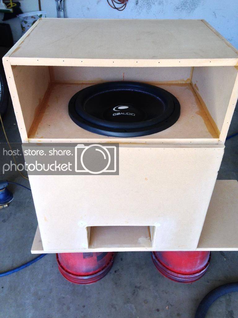

So I thought I would try a 4th order bandpass build. I am using the same sub I had before in a 3.5 cubes ported enclosure tuned at 34hz. Single C2 Audio Threatcon-2 15 dual 4ohm VC.
So I built this one. Specs are 2 cubes sealed, 3.5 ported at 45-46hz with a 50" of port area.

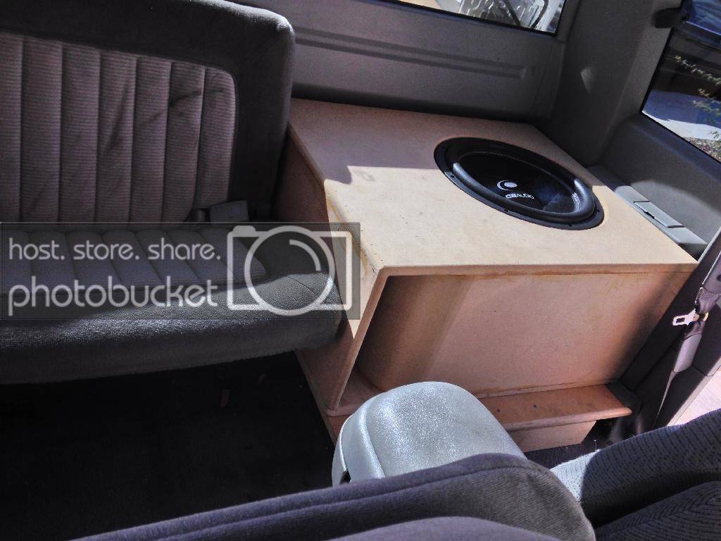

Forgot to get a picture after I rounded off all the edges.
Looks nice, and how about the output performance, is it better? Is it worth all that work?
It is, its much louder to the ear-o-meter but I will find out on the actual termlab soon to update if it increased. Lows respond much better. Still sounds great with all music.
how did you put the box together? Nail gun? I see the sealed side panel is screwed for access' date=' but the rest???[/quote']
Yes, sealed side with screws and the rest of the enclosure is brad nailed with 2" nails. Its hard to see with the roundover. Here is a cropped pic.
Looks great!!
Thanks. Can't wait to meter it.
