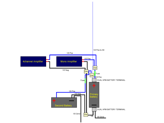

Here is a pic I drew up for my chrysler 300 2013 "primary battery is in the trunk" I have never setup a complete system so i drew it up to reassure myself. Please review my drawing and tell me
1) will it work?
2) is there a better way?
my main concern was fitting everything on the battery terminals. I found some stingers that accept x2 1/0.

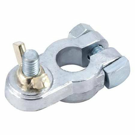

You can always use one of these terminals and use lugs on all the cables to just screw tight them to the battery.
Sent from my SM-N950U using Tapatalk

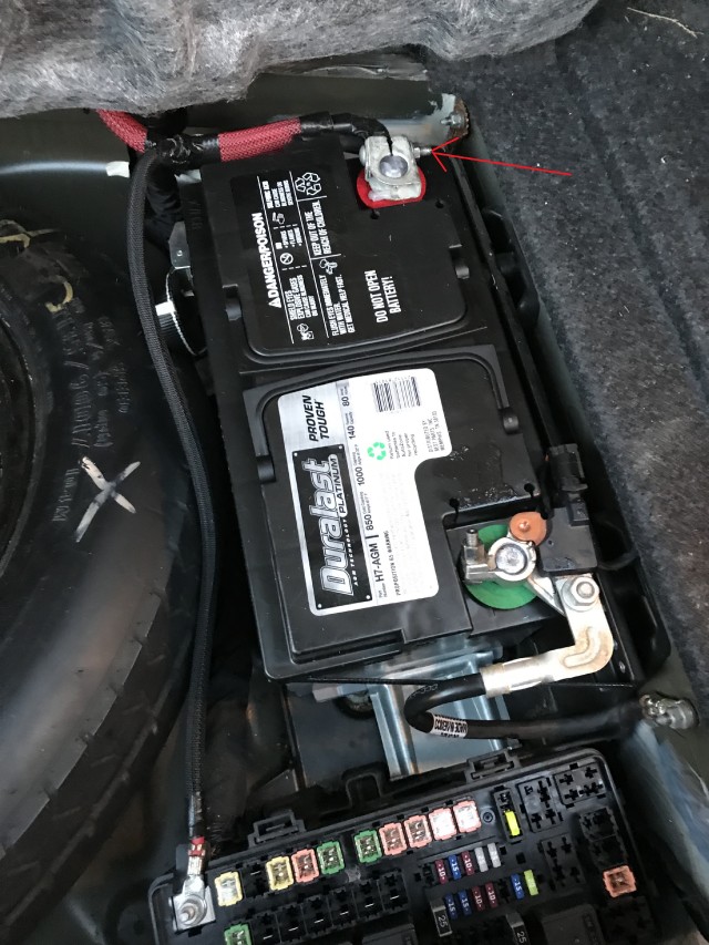

here is what the primary battery looked like stock. its already crammed running 1 mono.... that peice seems similar to what stock was.
WIll I lose power with 4 dist blocks like that?
What i posted compared to the photo are totally different.
And no you wont lose power with 4 dist blocks.
