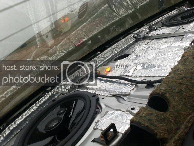

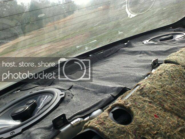

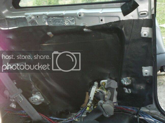

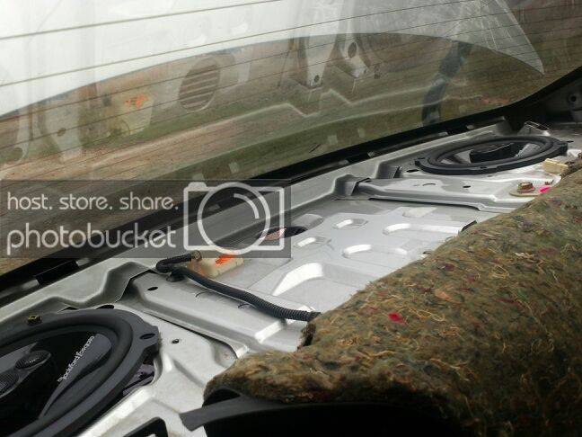

The rear deck - God aweful rattling. Besides the deck itself, rattling in the trunk comes through there. I suggest cld and ccf over this area. Also, add weight using MLV if your deck panel vibrates.

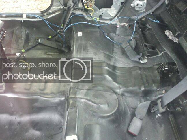

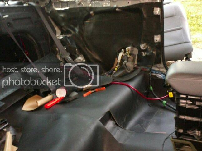

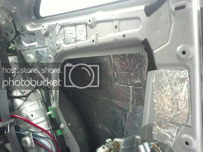

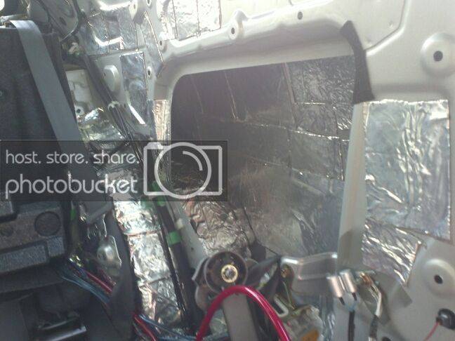

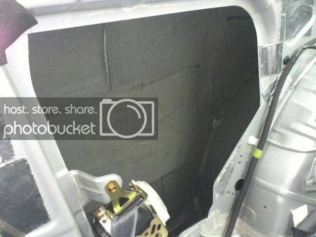

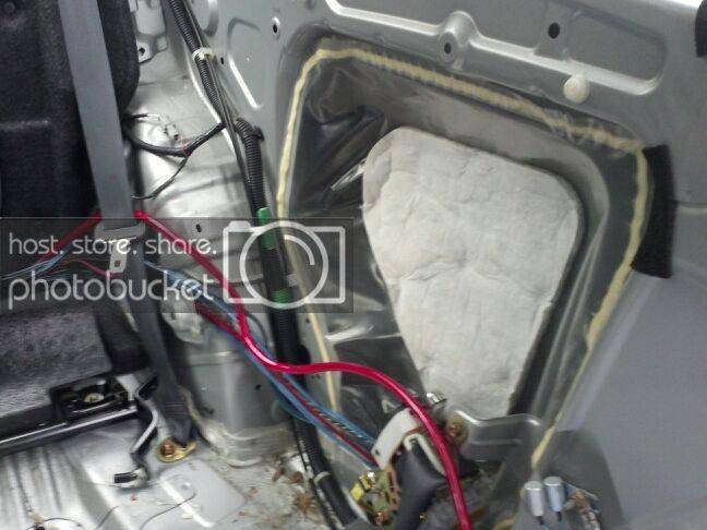

Rear wells - Probably the thing that worried me the most. After removing the panels, I could hear water puddles, dirst specs, and roaring wind, LOUD, coming from there. I suggest you give 100% coverage AND effort to this area. Seal it up, thick and tight. Its nasty at how much RACKET comes through there.

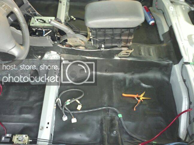

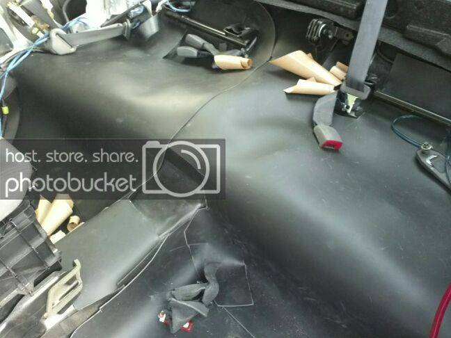

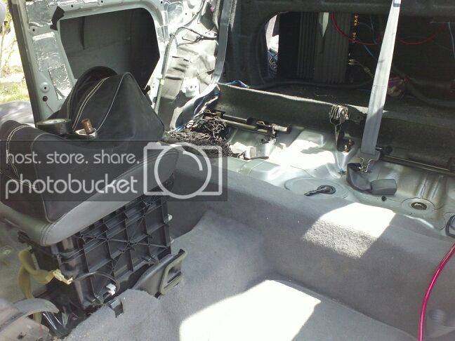

Back seat floor - The area under the backseat was loud. Water puddles and the road roaring come from here. 100 percent coverage no doubt here. ccf, mlv, and cld if you can, as much as possible.

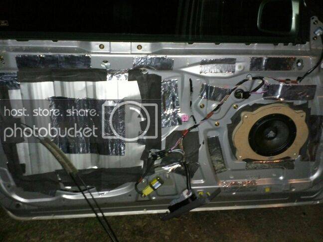

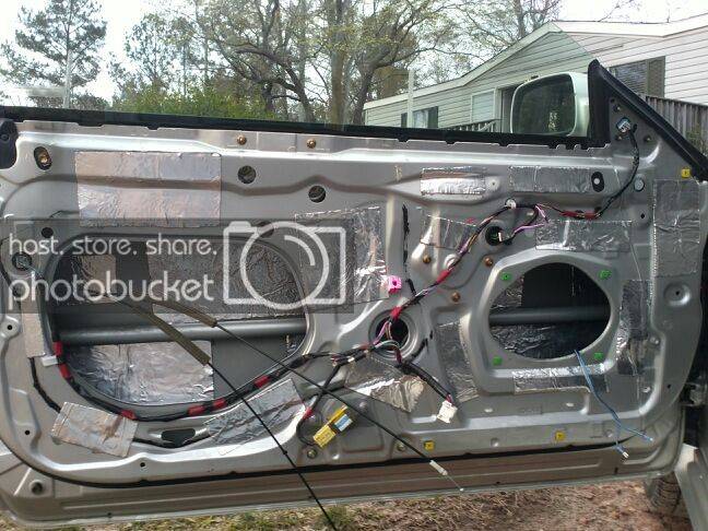

Doors - We all know about deadening doors. But road noise comes in here as well. CLD to stop the metal from vibrating and stop noise. I suggest 100% coverage on the door with CLD or MLV to get the best results.

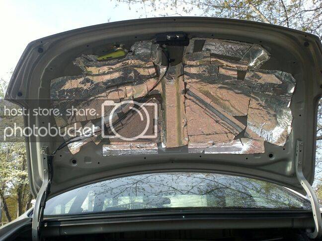

Trunk - Yea, the trunk rattles on the outside of your car and it sounds stupid. But that rattling comes into your car also. 100% coverage on the trunk lid. Also, ROAD NOISE comes from back there too. Back seats im sure block most of it, but if you can, 100% coverage of the trunk floor with watever material you can.

Rear deck

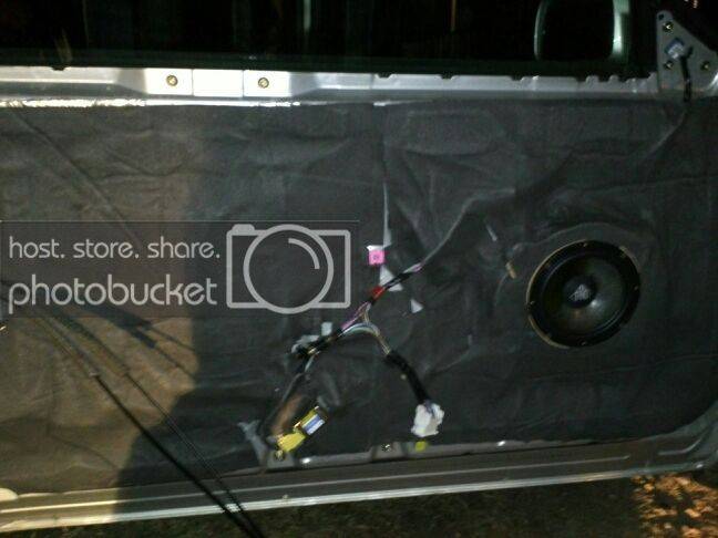

Doors

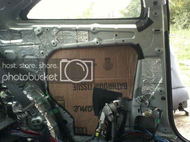

Rear wells
