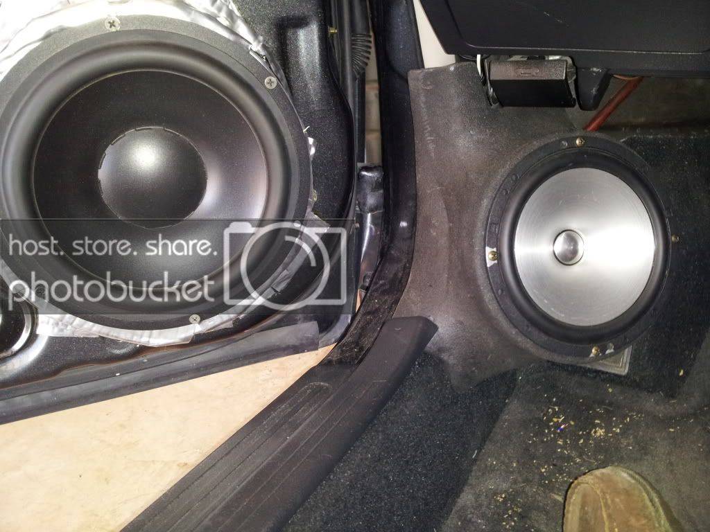

i have ran a 6.5 in the kick as a midrange and a 6.5 in the door as a midbass. nothing wrong with using 6.5 for both, but separating them with an active crossover. the midrange will be much clearer when you put a 250Hz high pass on the woofer.
that is my vote for you: one 6.5 in kick as midrange. one 6.5 in door as midbass. active crossovers.
if you want to be slick about it, you can build up the doors to accept an 8", but have a replaceable baffle. so you build a baffle to act as a mounting surface, then make baffles that secure to it (t-nuts and machine screws, 10-24 would be fine). this way you can easily upgrade the midbass in the future, if you feel like you need it.
in a properly sealed door, a 6.5 can play down to 60Hz with ease.
