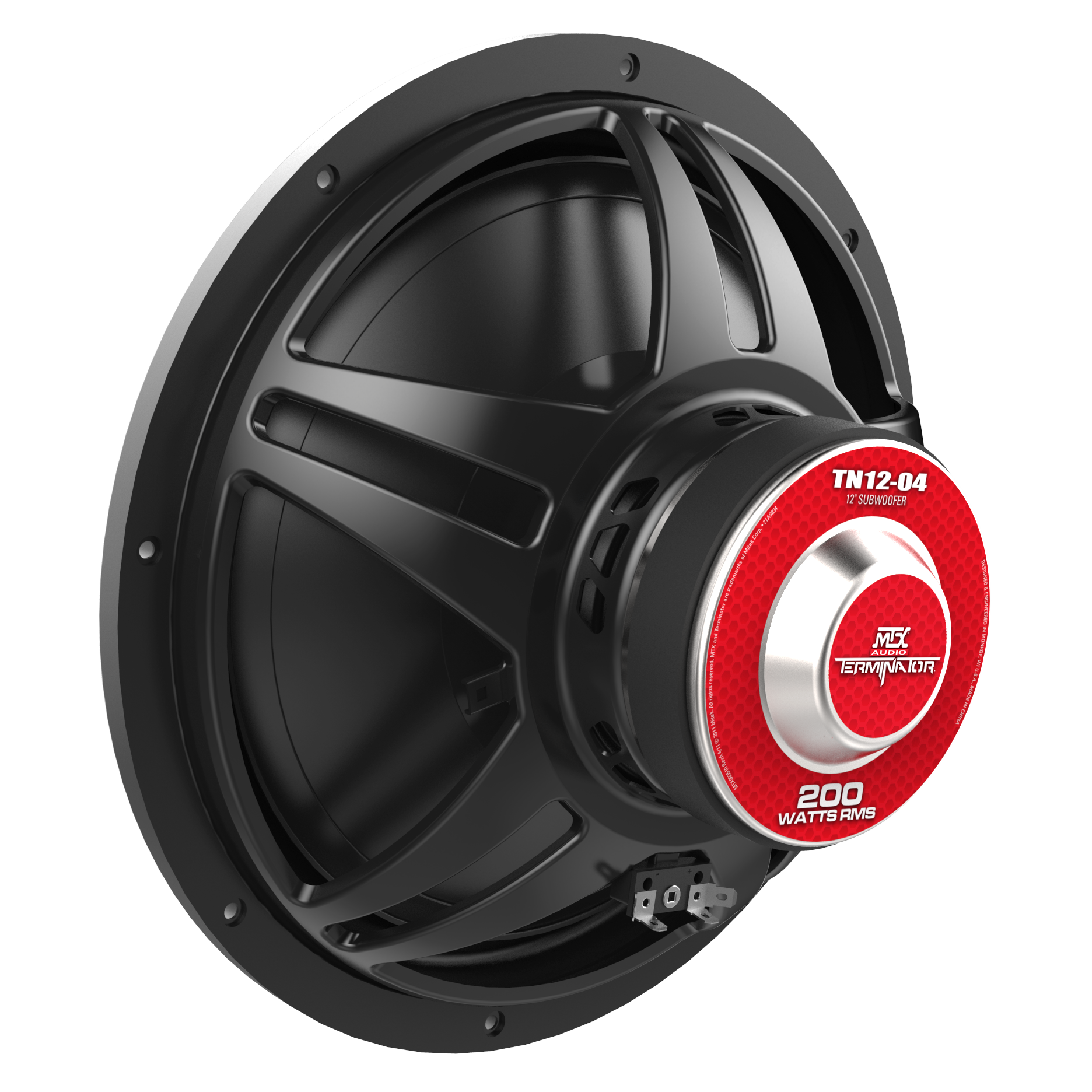

Terminators are 200wrms subs. They took the place of the old Road Thunders but are built with far lower grade parts. They don't have a strong enough motor to control the cone and are designed for sealed boxes. Thats what had me laughing at the beginning. They are fit to be sold in a Walmart.
