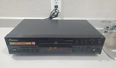

First off, get yourself one of these:
Convert all your aging tapes to CD then you;re not limited on HUs you can source. I did this years (with Elite PDR-99/ Elite Cassette) ago and never looked back.
