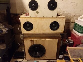

Going a little nuts with the shop stereo in between waiting on paint to dry. 4 16ohm buy out specials 4" mids crossed over at 800 to 5 k. The 2 eminence 4s will handle 100 to 800. Tweeters 5k up. Need to separate the enclosure on the inside and add the ports for sub and the eminence. Should be a pretty efficient set up. I've got an old plate amplifier with high level inputs I might incorporate for the sub. Fun stuff lol.20190407_155207.jpg

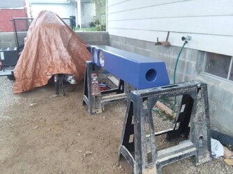

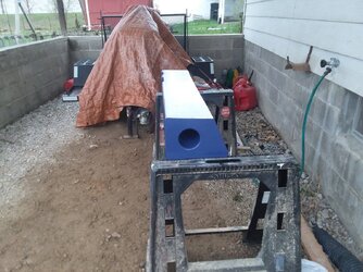

I'll have to wait till next weekend to try it out but pretty much done. Hard to get too excited about a pair of 8s but after all the work put into it I'll still be looking forward to trying it out. Hopefully it'll put the problem of front facing side port in that truck to rest...

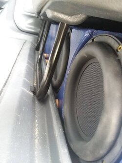

Temporarily locked into place till i can put some pieces in that are a little more discrete. Had to do a fair amount of running around this weekend. Box was worth the effort.  The little ultimax dig deep for 8s.Just works better front fire etc. Idk about thoes fox boxes and all the others firing up down etc. Didn't work all that great for me up or down in my little truck anyway.
