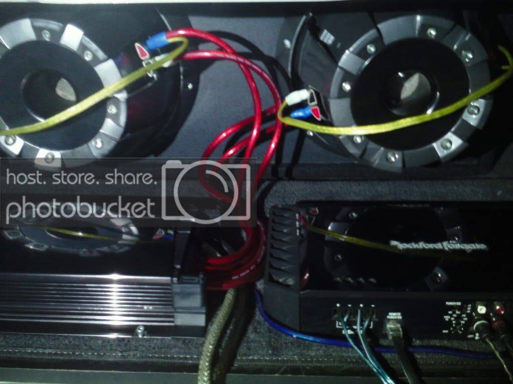

I flipped mine to get every last cubic foot I could out of the enclosure and you have to do some math to figure out what your tuning is going to end up being, but as far as the motor getting hot they actually run cooler because there's no hot air surrounding them and as long as there's an air cushion on one side of the cone(box) the sub doesn't care which, and I like the way it looks!
yea, I love the inverted look, but i am too afraid to do it bcuz of people! I have lots of friends that know NOTHING about car audio, and would be like, "ohhh, TOUCH, POKE!!" and I dont feel like killing anyone, Is this a problem or a irrational fear??

it won't kill them but it will let them know not to touch it again! ask me how I know!
