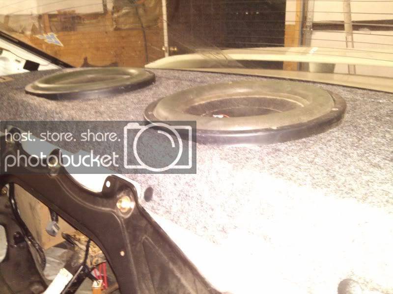

by the way i dont want to hear any negative comments on my question, alot of people who have nothing better to do just think im nuts, Here's a photo of the last car i had, it is the box in a 2002 nissan maxima with two american bass VFL subs at 1.75 CF of airspace sealed (should have ported it with that much air space) so dont think im not serious about the deck, ive done it before and the sound quality of using the deck is absolutely amazing!
