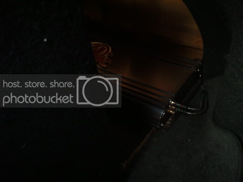

currently mounted with velcro, but it dosnt seem to be holding that well, any suggestions???
i plan on putting the other seat down aswell and putting my other amp thats coming on that seat... or maybe i should just put them both in the trunk (is it okay drill both amps ontto the back of the box?)
also, how far does my subs have to be from the back of my seat when it is up? about a foot?
thanks
if you want loud keep the box facing back and about 5" off the trunk lid as for the amps ditch the velcro and run screws (short ones) into the back of the seats also think about securing the box down so it doesn't slide back/forward, I used two S.S eye bolts through the trunk floor with a little sealer and they hold nicely with a ratchet strap

actually i just turned them around just now, they were as close as yours before but i tried this? im not sure whats better.

didnt really wanna put screws into the seats, but i might.
also the first video is a wine my amp makes for some reason, so i was thinking of putting them on the back of the box so i dont have to hear it ( if i leave my subs facing how they are right now )
tips?

just about every amp ive ever mounted on the back of the seat always got too hot,and shut down,on bass..collect too much heat
why would putting it on the back of the seat make it hot?
what do u suggest i do
Mounting amplifiers with screws into the back of a seat is a very common solution. It's not ideal for amps that run hot because with the seat up the heat sink can get heat soaked. Heat rises. If you have the room for it you should mount the amp laying down between the seat backs and the boxes. There are other ways to manage the heat but this is an easy solution.
