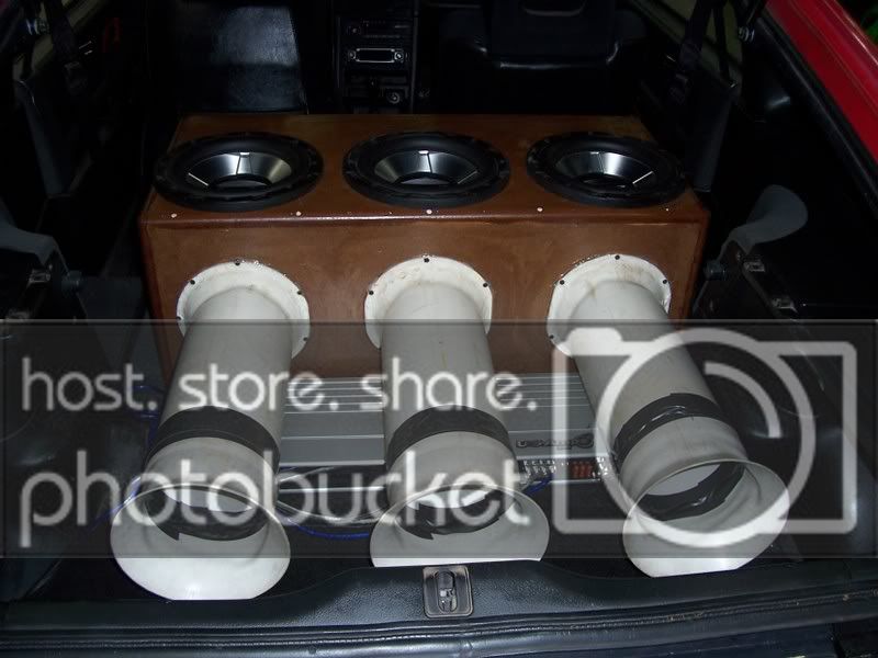

I have been curious about off-axis firing myself, so I decided to give it a try and built this box. It did the exact same score as the other box I made that had box subs on the same axis. It did a 150 at the head rest and 151 + in the kick panel with 2 Type R 12's.
Even a squirrel catches a nut every now and then. Consider your other box useless if it can't outperform that one.
