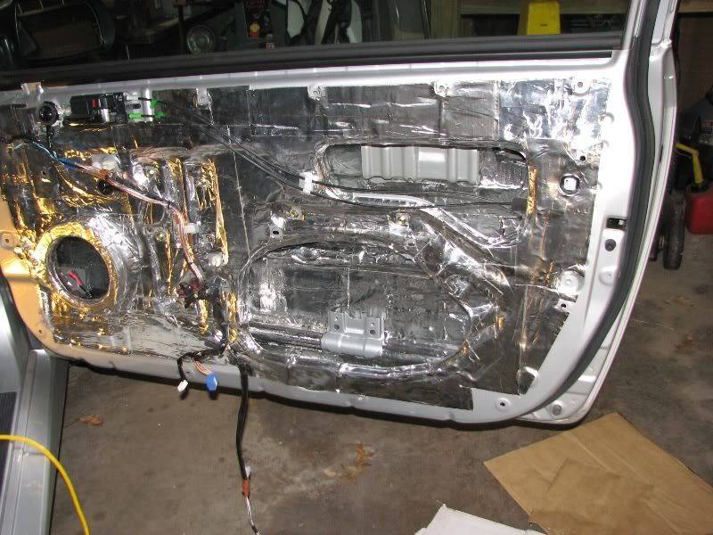

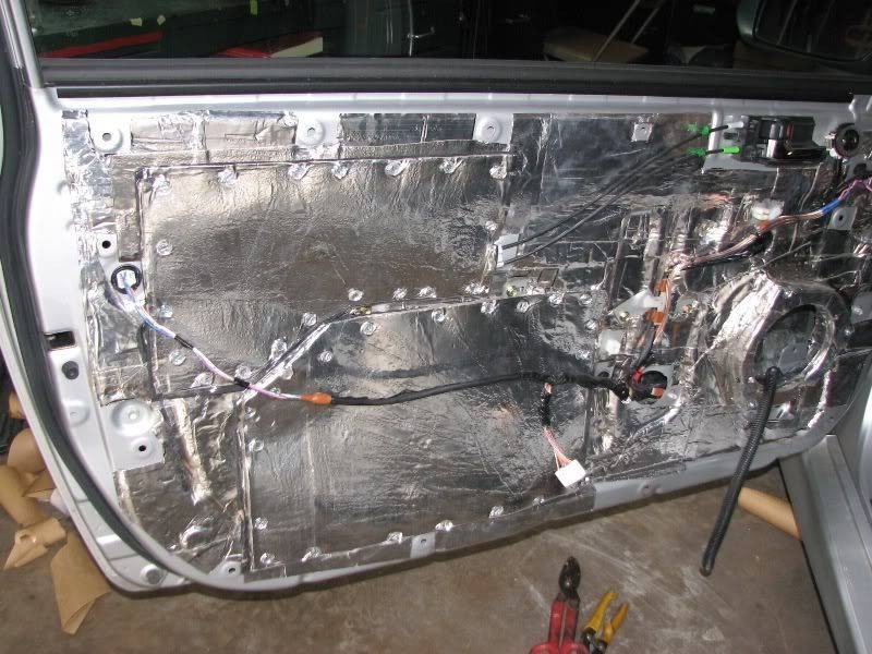

on the scion we had the doors like this for a few months
midbass was ok but not great. everything was good but we knew the ML woofers could be better.

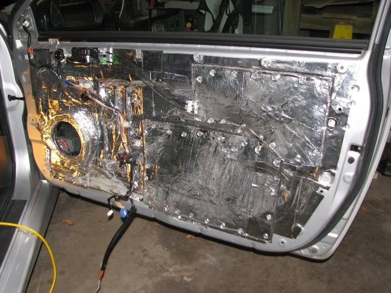

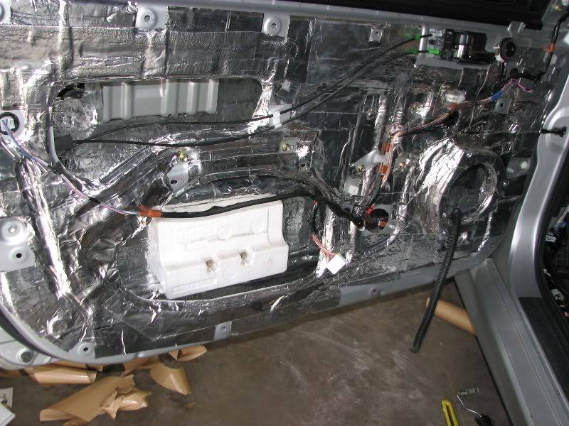

then we closed them up like this:
amazing difference. more midbass than we could ever want or need. ran without a sub for a year and had useful response down to 50Hz with the ML-165 woofer.
thats about what my doors look like except my panels slide down on to the door so i had to leave roughly six 2x2 holes for the hooks on the panel to attach the door other than that the only place my seal is broken is the front of the speaker to the panel which i agree needs to be fixed but i cannot see much gain there.
