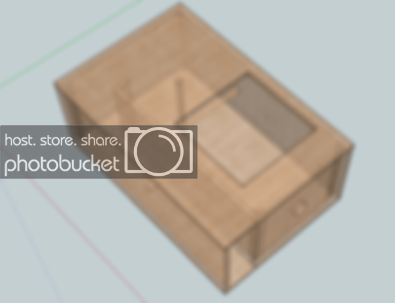

If you do that, you're probably going to be stuck inverting the sub.. It's going to hit the port unless you offset it in the corner. Not sure that's a good idea either. Why not just fire the port toward the rear?
Could do a similar design to this one.
