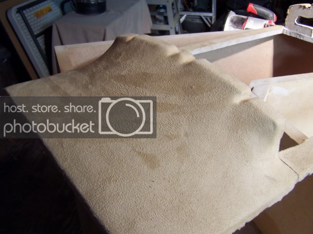

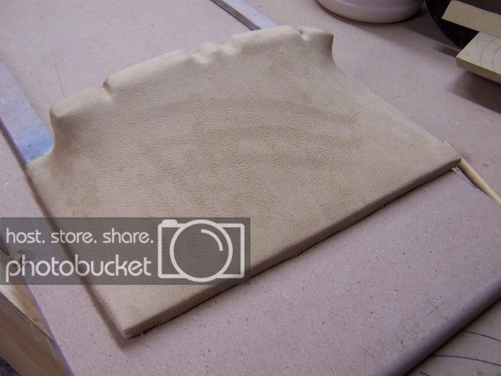

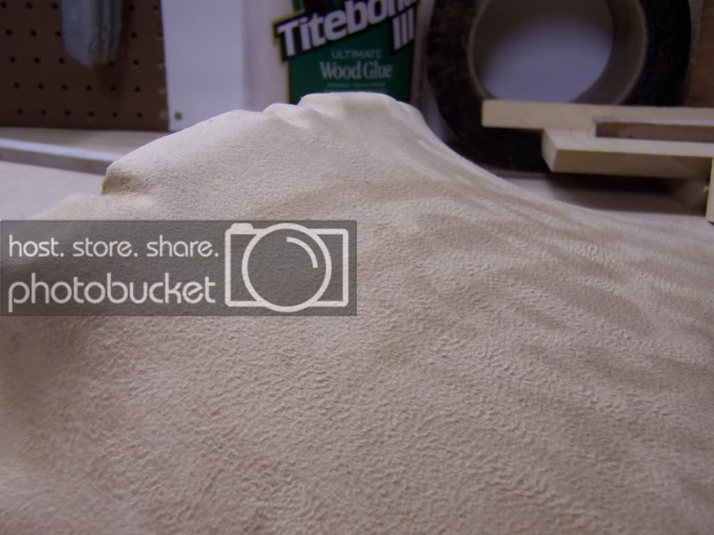

a small update on this. im sick of it sitting around, i dont have the time to prep it for paint, so i decided to wrap it. this amp is in the process of being sold, so i just want this finished up.
tan suede i had laying around, close enough to the interior of my truck...
other side should be done tomorrow or the night following.

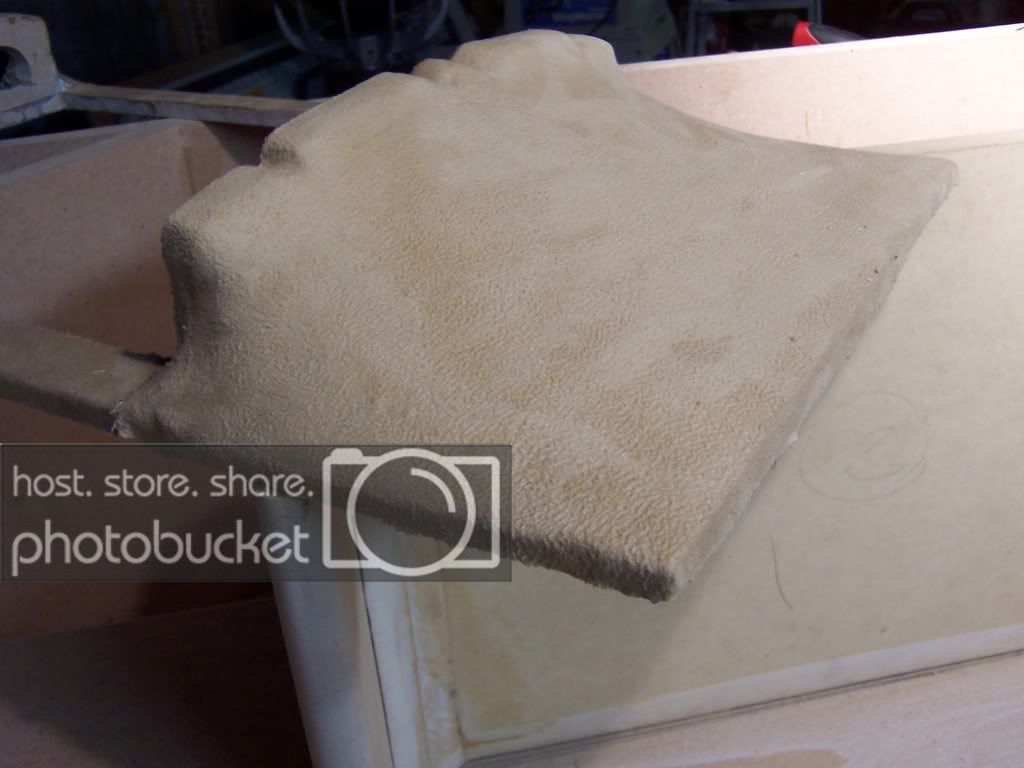

so i ended up wrapping this, im not sure if i like it or not though. the sides are not perfect because they wont be seen. just the ends. ill try to get it installed tomorrow or this week so to decide if ill keep it that way or not. keep in mind this is my old setup, so this wont be in the truck for too long...
Not bad my man, not bad at all. Next time before you stretch the fleece. Cut a rabbit in the lower panel where you stapled your fleece. Then staple the fleece in the rabbit. Makes finishing an arse ton easier //content.invisioncic.com/y282845/emoticons/smile.gif.1ebc41e1811405b213edfc4622c41e27.gif
thanks guys.. i know about the rabbeting trick, thats what i typically do, but my router shit the bed the week or too that i started doing this... i was going to warp the material underneath, and i forgot i would be able to mount it if i did that, but it was too late... like i said, this wont be in the truck for too long, so its no big deal.
I se a table saw in one of your first pics. Set the fence 1/4" away from the blade. Set the blade height to match the depth you want your rabbit. THen get to cutting //content.invisioncic.com/y282845/emoticons/smile.gif.1ebc41e1811405b213edfc4622c41e27.gif
youre right, i couuld have done that. i didnt think of it. ill remember this thread in the future, if my router fails me again haha.
